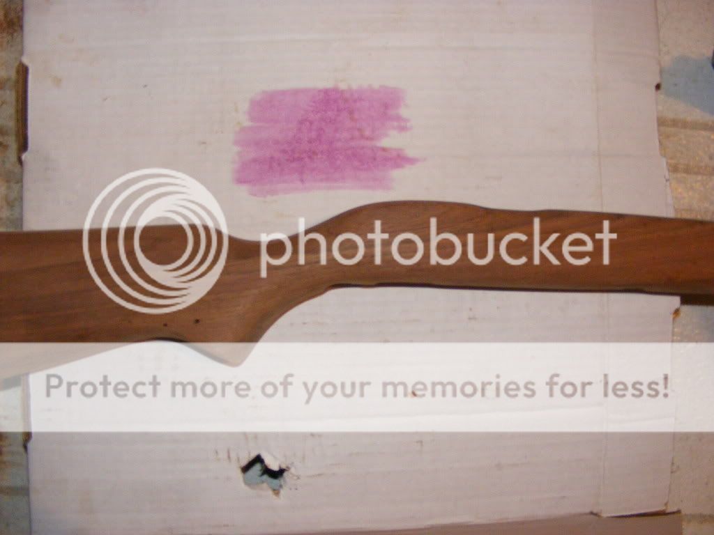

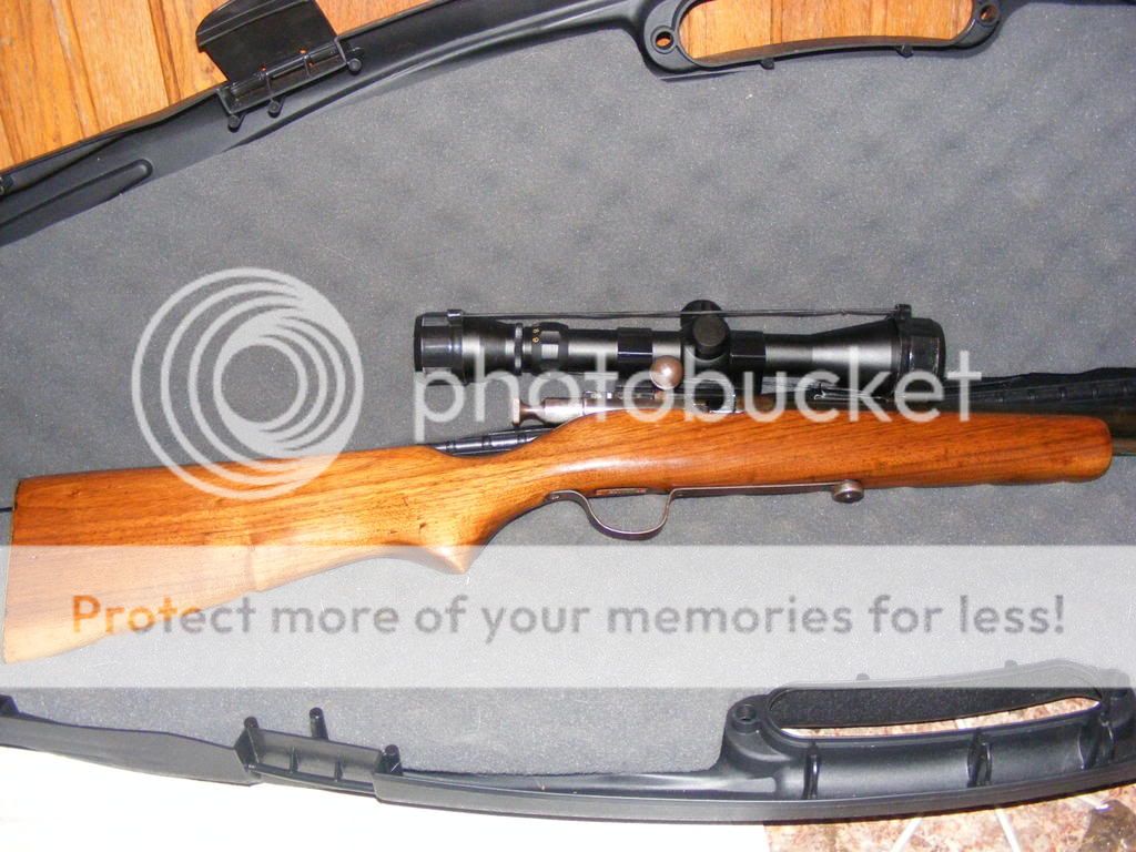

So I saw this color in the store and I thought it might be interesting. Let's hope so.... It's called Cherry Blossom. Sounded feminine, so I decided to make my Cooey " girly"
This is the before:

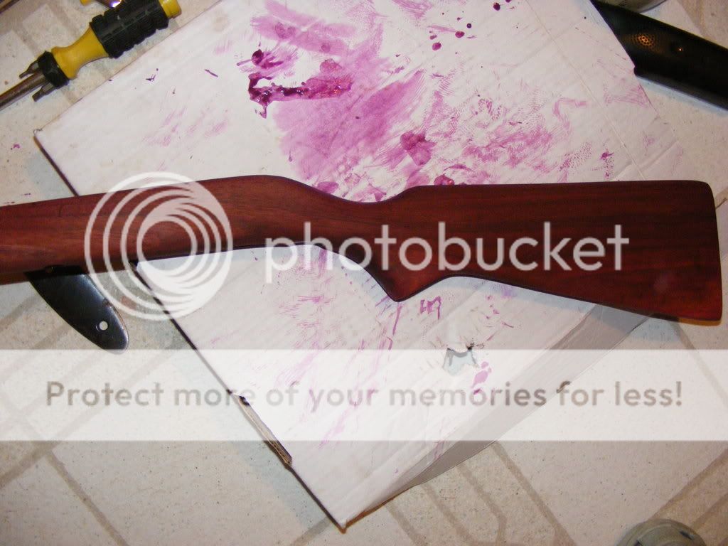

This is after sanding (it's too cold out to use the vile stripper and I have no shop) The pinky purple blob is the stain color:

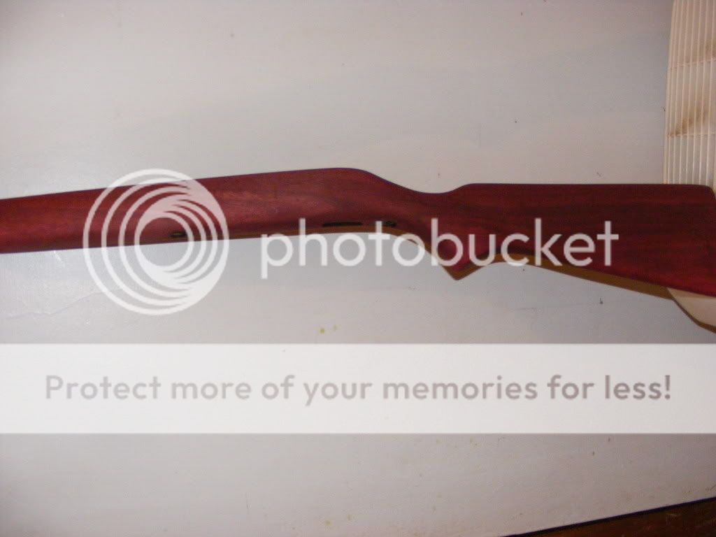

Ok, coat two is done:
Ok, I think this is coat number 6. This is getting fun. I can't wait to put the tru oil over it so it gets shiny!!

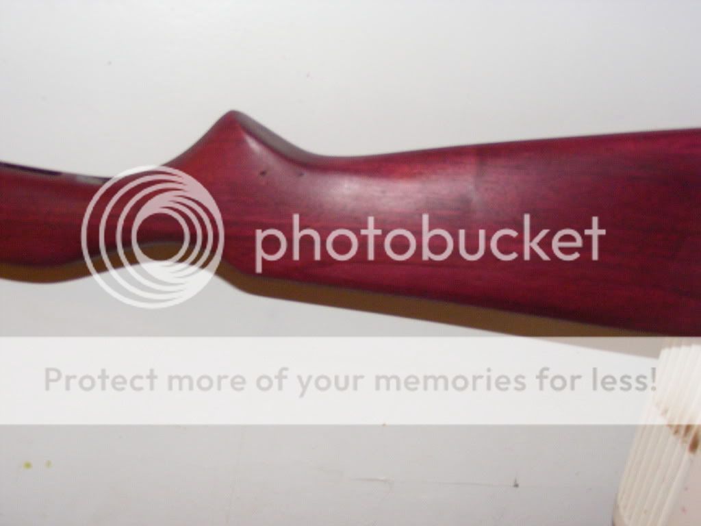

I have done about 10 coats now so I think this is all I'm going to get. I was kind of hoping for it to be a bit more girly but I still like it. I am going to oil it soon.

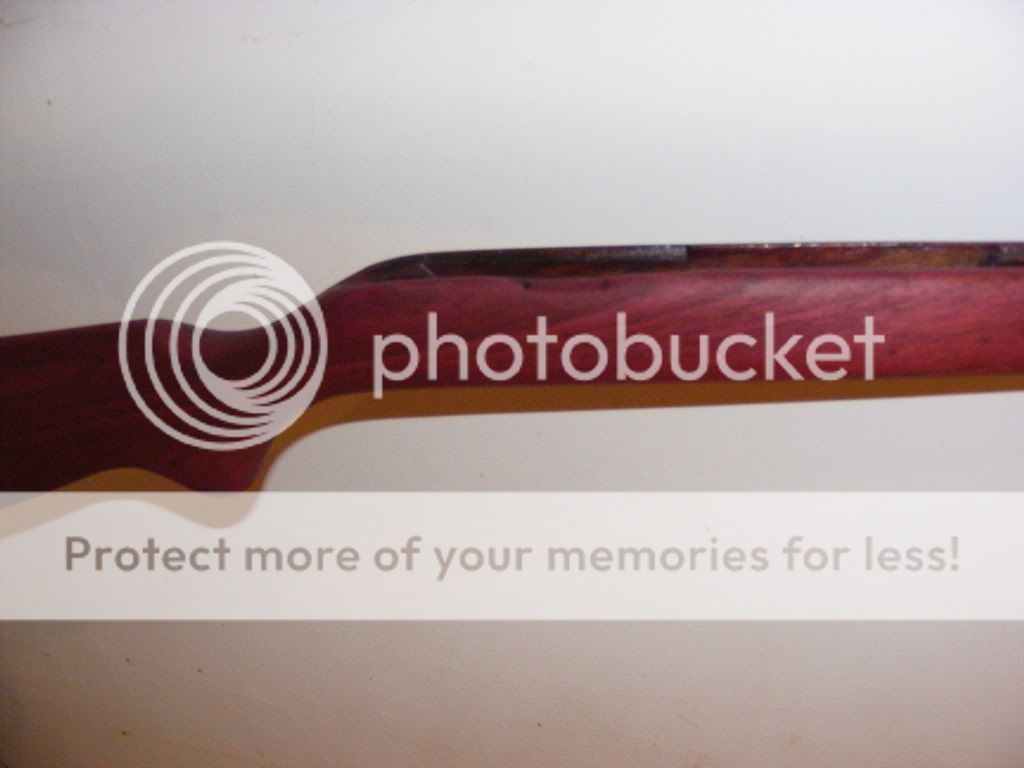

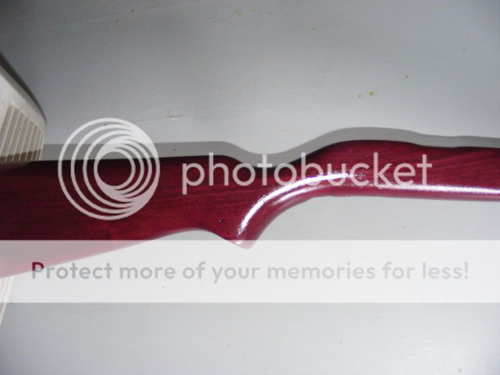

Ok, two coats of Tru Oil, Now I just want to re-blue the barrel and it will be all pretty! I'm pretty happy with the color!
Ok I am done now! Hard to get a good pic taken, I see why there are so many feet in pictures... lol.
