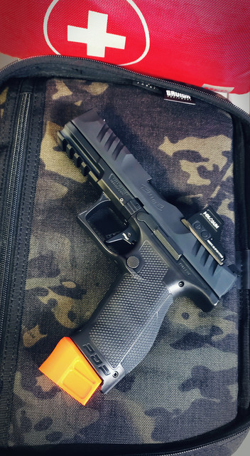

Just like the title says, I was excited about buying stuff I didn't really need for my new PDP, when I realized the only option for extended basepads where in the US... at $30 US each...

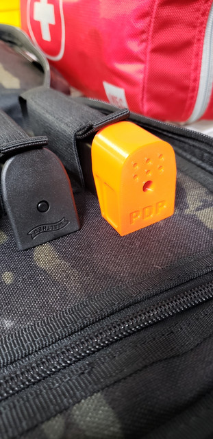

I have been tinkering with Fusion360 as a bit of a side project over the past few months... so I figured I could probably make my own. Turns out I can. (Don't worry RCMP, these are +0 pads and do not add capacity)
I'm actually pretty happy with my design, and even just being printed in standard PLA can take a few drops on concrete before starting to show it.
Let me know what you guys think.

Right now I am just printing these out of standard PLA. Mostly because I already have a bunch of it, and my PLA slicer profiles are pretty tried and true.
This is actually my second version of the basepad, and I have been doing some destructive testing. With these angled basepads the load of the magazine bottom lips are spread across several layers, which helps considerably with the durability. As-is I can get 3 or 4 drops on concrete from shoulder height before cracks start forming. Pretty well unlimited drops on the ground outside.
I'm going to design and print a TPU bumper for these, in hopes that helps dissipate shock load when dropped on hard surfaces.
In regards to putting the stl out there... I'm not sure what direction I want to go with these.... I'm considering having a run of 100 milled in aluminum, in which case I will have extras to sell... Selling printed pads, or even selling the STL for personal use are also on the table.... but at this point I'm keeping the STL private, at least until I decide what I want to do with it.

Thanks for the support guys! A bit of an update on this project is I am currently working on a "Version 2" of these pads. Dimensionally they will be the same, however the new version I am testing is printed out of 2 different materials, giving the bottom of the pads a bit of squish, allowing them to absorb the shock of a drop onto a hard surface. My preliminary destructive testing has gone really well, allowing the magazines to be dropped from a second story window onto concrete without any damage. I am hoping I have a finalized version that I can offer for sale within a week.

I bought these basepads and can confirm they fit my PPQ M2 mags
