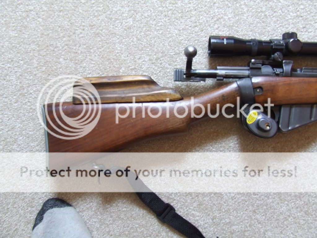

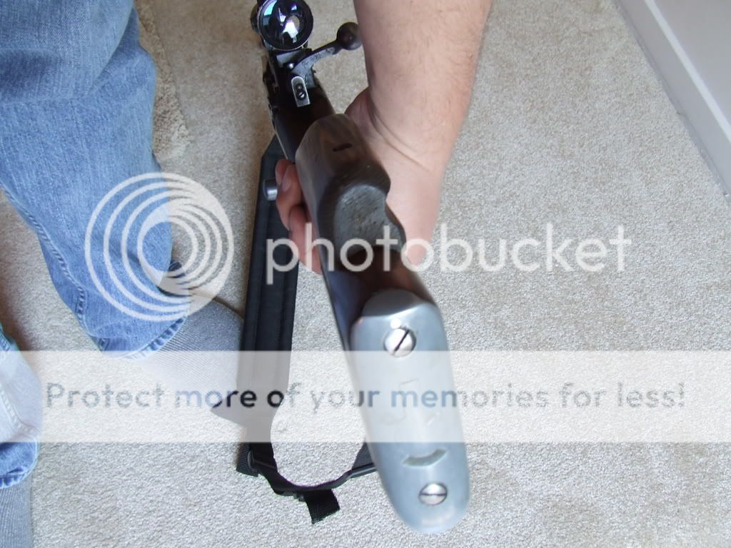

If the problem is too low a stock and the stock is already in sad shape then simply mount a piece of wood on the top and carve it to whatever height works for you.

That looks pretty damn cool Murf, might do that if the ati stock is a POS.
