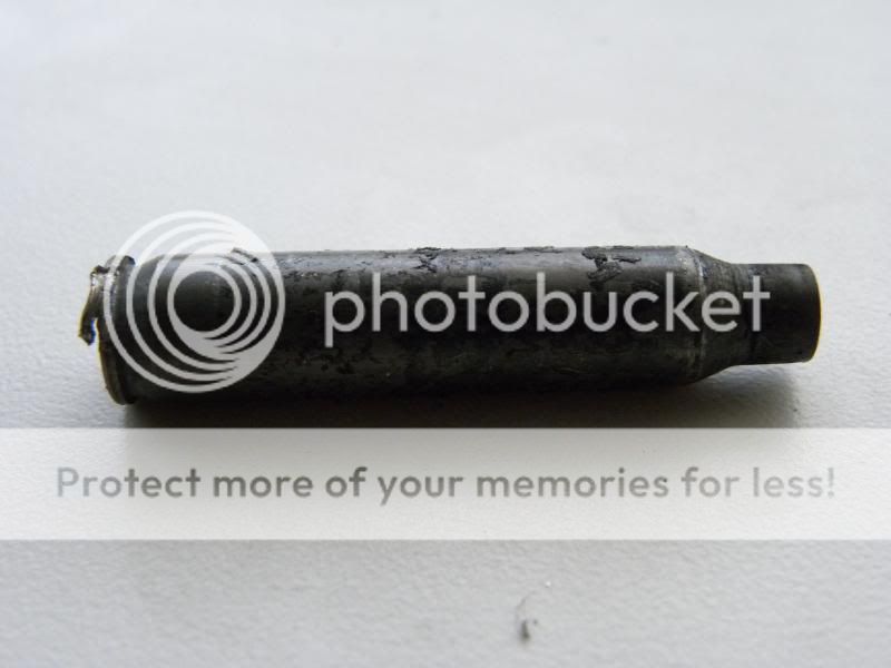

Had my Marstar CQB to the range today (Great service BTW) and had an issue. After about 80rnds I had one stick
in the chamber. I'd been shooting both tula and norinco. It was a tula that stuck. I splintered a wood dowel trying to
knock it out at home, you can see the ejector pulled a chunk off the rim when I tried to pull it out. Anyone else experience
this? The gun is only a month old and hasn't seen more than 200rnds. I think its the lacquer build up/melting.
Thoughts?
I'll try to add a pic later, the case had a black flake all over it.

Did you clean the barrel before you began shooting? Looks like it was just gummed up really bad and the case got stuck in the "GOO"
I read a thread somewhere once that said you shouldn't switch between steel and brass cased ammo without a good cleaning or exactly this would happen. That looks like carbon to me so I would think a cleaning would solve it.
