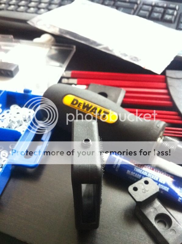

1. Drill and tap to add a set screw to the belt loop. This mod is great! No more worries of the pouches moving and no need for zip ties or black retention tabs. The pouches are very secure on the belt, wont budge without unscrewing the set screws.

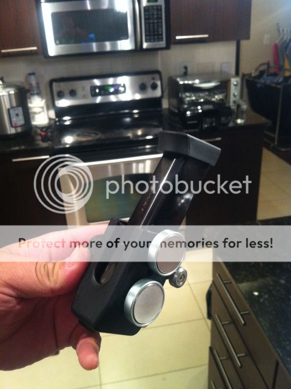

I tried just using one magnet but i found the mag spinning and moving slightly from time to time. With two magnets it's rock solid and very smooth.

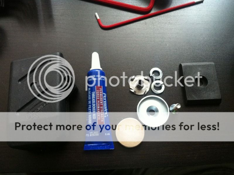

The best way to attach the magnets and holder is by drilling and tapping to the pouch. Since the CR Speed pouches are plastic drilling and tapping wouldn't work. I had to get some extra hardware from home depot. I used #10 screws and flat locking plate. I used 1 lock washer on the inside and two flat washers on the outside to make for a perfect fit.
I originally used the CZ / Beretta back plates for the CR pouches but had to go thinner to accommodate the new hardware inside the pouch. I am using the SVI / STI back plates with some minor thinning with dremel.
I added some contact cement for the internal flat nut and red loctite. It might be overkill but the magnet and screws aren't moving.

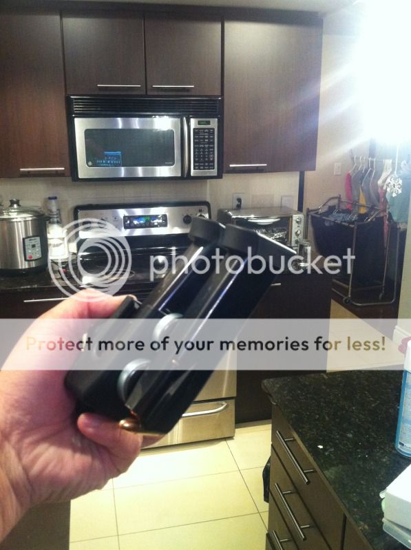

Final product..........
