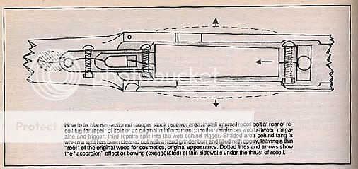

Here's a sketch to show what I mean

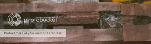

Take a look at this picture. It shows a short piece of 1/8" threaded stock dropped into a groove that was routered side to side in the wood behind the magazine(this is one of the few jobs where a Dremel can come anywhere near a stock). The metal was long enough to extend into each side of the stock. The idea is to embed the threaded metal in bedding compound, in this case Acra-glas gel
This picture shows the stock after bedding. I also embedded cross-bolts behind and in front of the recoil lug. The stock was going on a .375 H&H. (the white stuff is paste wax)
