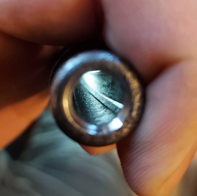

Bore is quite pitted, but lands are strong.

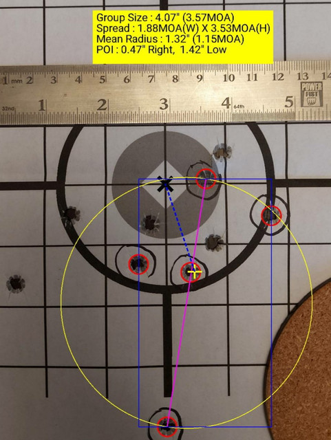

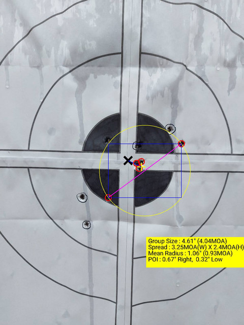

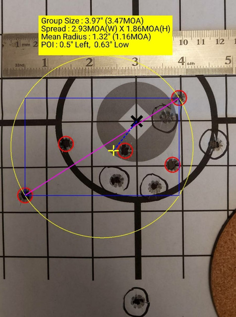

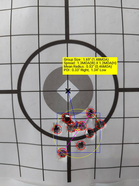

I've been shooting reloads consisting of 218 grain swedish pull down bullets and powder. The pictured groups are 45.2 and 45.5 grains of the swedish flake powder. These were shots 12-16 and 6 to 10 respectively on different days. oal is 3.250
I'm shooting the gun off of sandbags at 100 meters. Its sitting in a israeli stock that fell victim to Bubba's rotary file as well. I have the barrel free floated minus an inch behind the bayonet lug. Action is epoxy bedded. Some of the other loads I've tested average about 3 inches for a 5 shot group.
