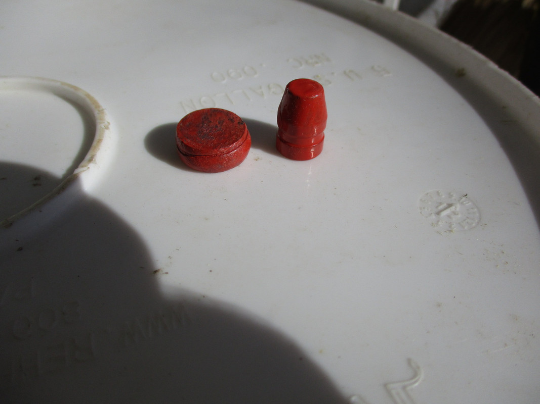

My pc coated bullets can be hammered flat and the pc sticks to them. Your 45 were pealing from the case mouth. It is either too thick or it is not reaching the temp to stick properly. PC only needs a light coat to do its job. Less is better sort of thing. How do you apply it?

I use the shake and bake method. I'm trying a little more crimp and so far it doesn't seem to be pulling the boolit back out as often when I lower the ram on the Lee turret press. I don't try to put a heavy coat when powder coating however some powders seem to coat thicker than others.
