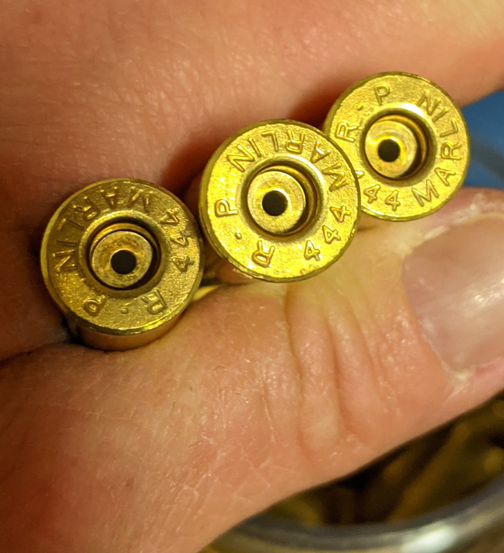

Can't say I've ever had this issue, levers are my favourite but i factory crimp. Specifically .444, it's nothing fancy but this RP brass I've reloaded 20 times for sure.

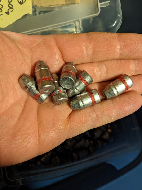

You can see the edges are a little bit but the pockets clean up nice and it feeds/ejects smooth. I have many pets for this rifle, sometimes I like to shoot jackets hot and I really enjoy lobbing heavy cast pills with lighter loads as well.
30-30 in a win with mostly win brass and .308 in a blr mix of headstamps for bottleneck cases, less variety for each but same spread of hot and light loads I play with and i use a factory crimp for each. Seated to desired oal previously.
