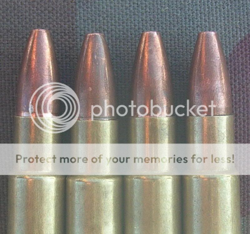

This is why you crimp. The various stages of being driven back into the case under recoil. They are 350 grain Barnes X in a 416 Rigby.
