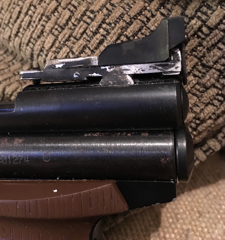

Well I can’t say I could be happier with the steel breech for the 1377(crosman canada). Great piece and a fantastic upgrade to the platform. I made the sight out of 1/2x1/8 aluminum from CT. Tapped for 6x32 screws which CT carries. The hard part was making the dove tail which is very tight. I added about 1/4” to the front sight and it shoots dead on for indoor short range. All done on the den table with no special tools. Plugged the hole,shrank the trigger spring and added weight to the hammer. As you can see it needs some fine tuning which is as easy as loosening 2 screws and giving it a tap. Works good!!
