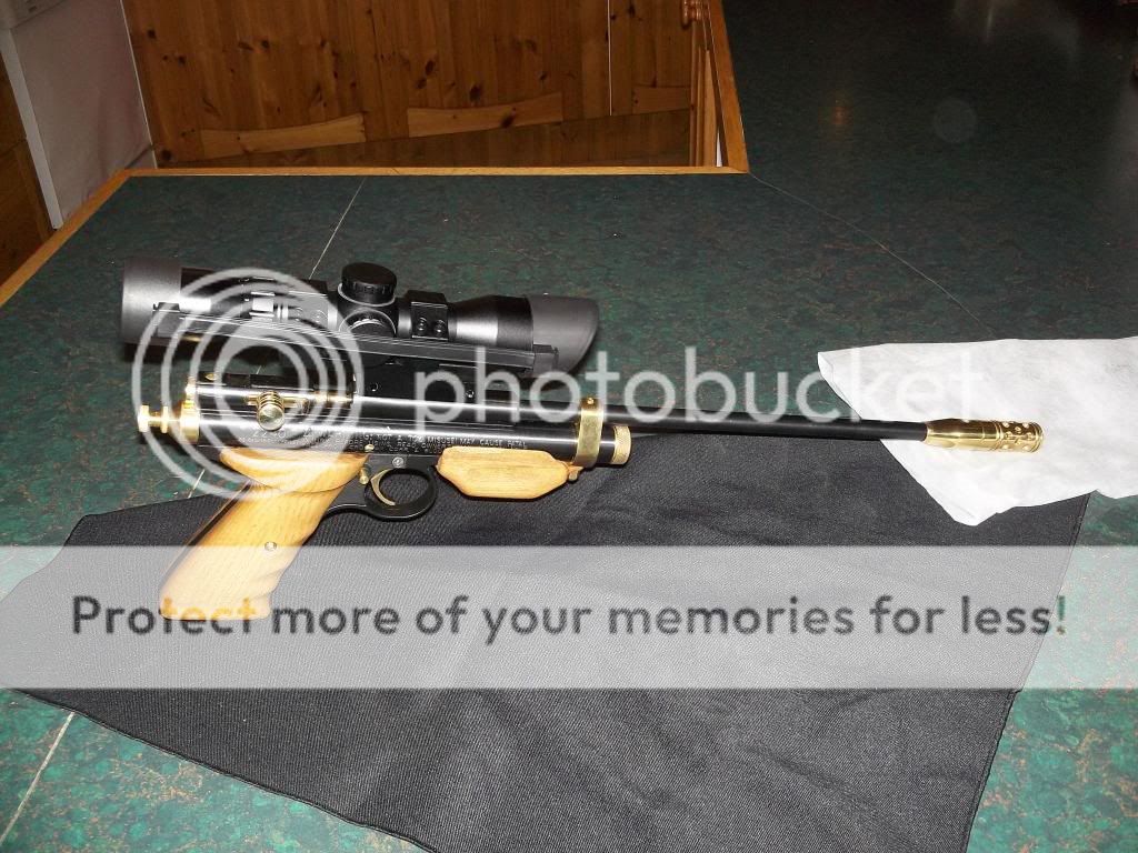

It was cheaper for parts for me to buy a custom pistol partially modded to strip for parts to cannibalize as well as a stock 2240 to build one and sell the other.Steel breech,.22/10" barrel, polished/modded valve for smoother CO2 flow with walnut grips.Will add a custom brass velocity adjuster ,LPA rear sight ,shoulder stock and a brass muzzle brake with black steel pin front sight. Came with a 4 MOA Red dot as well. These can be modded for HPA as well but best for carbines to keep them under 500fps.[keep in mind there are two different lengths of steel Crosman breeches short/long if optic are in the cards get the long version]

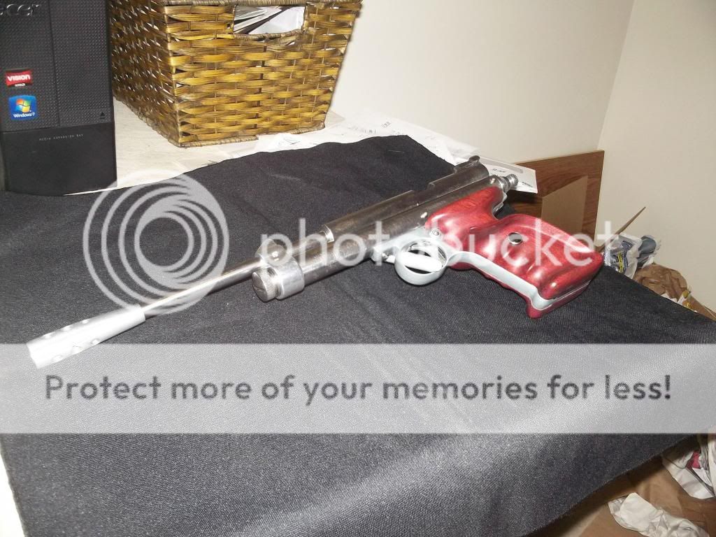

I built a custom 2240 in .25... Bought a BNM repeater breech for it, and increased the barrel length to 18". Without messing with the valve or spring, it was perfect for keeping fps up. With lightweight 20gr pellets, they shot around 485 fps. With standard 25gr pellets, I chronied them at around 455 fps. It does a solid 24 shots per CO2, so I bought 3 of the M-rod repeater mags so that I know when to replace the cartridge. Turned out really nice!
At about 14" from what I've read with the 2240 platform barrel length slows the pellet and drags the last few inches.Supposed to be the most efficient length so they say. Is your .25 barrel choked and what brand Lothar Walther ? My custom 2240 is almost complete and I have my MK1 back all new seals and polished valve .Will chrony to find out the fps to keep it legal then decide on whether to go for a custom longer barrel to creep up to just under 500fps.................Harold
It's not an LW barrel, and not choked. It was just a normal barrel supplied by BNM. It seems fine, but I wouldn't consider it to be match grade.
That's odd that you'd seen 14" as optimal for barrel length... I've read that 24" was optimal. Makes sense to me, as my 18" barrel is getting surprisingly good velocity. Still, would be good to see a comparison of different barrel lengths and associated velocities with CO2!
