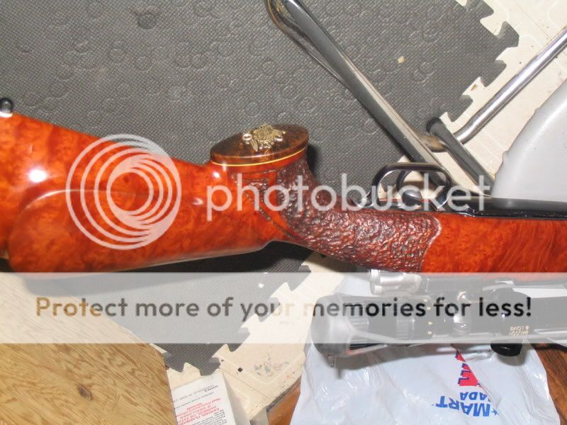

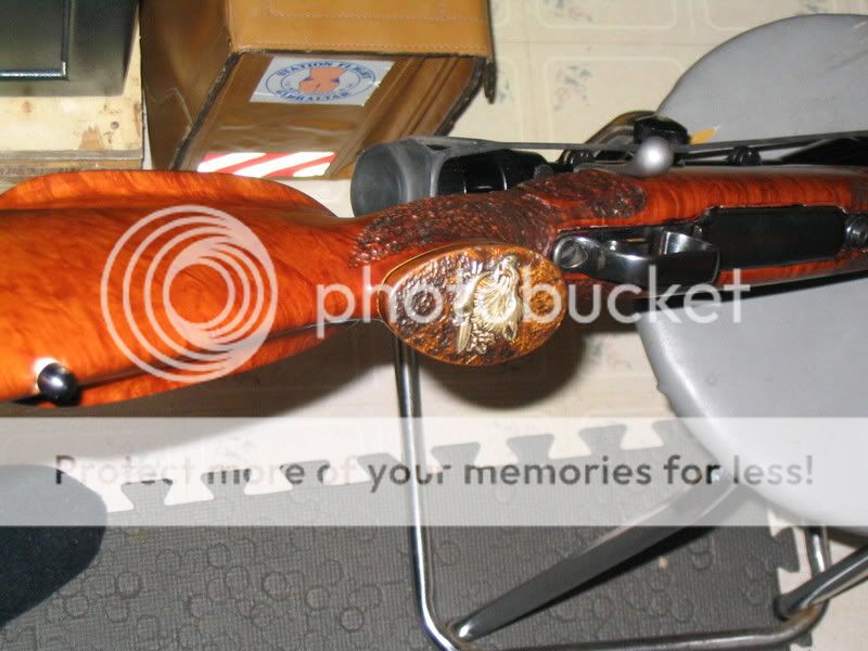

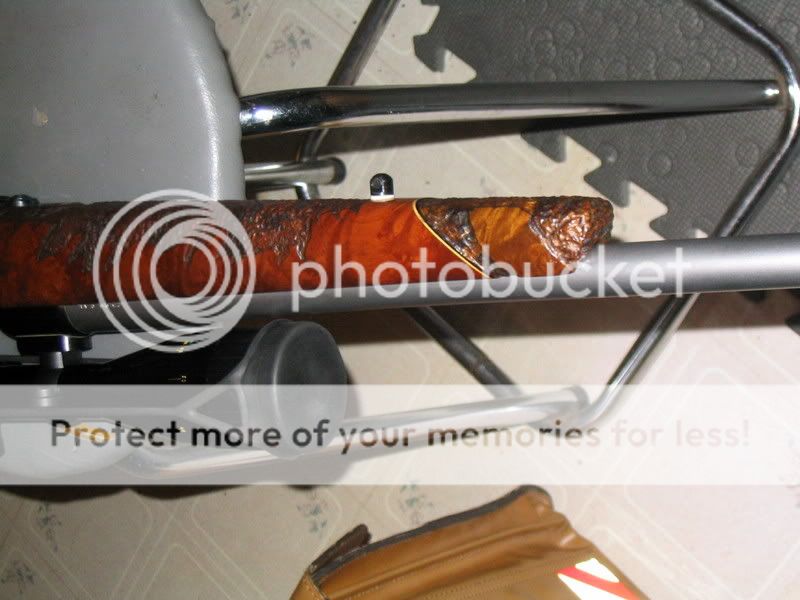

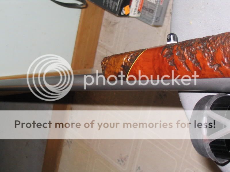

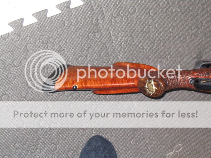

Pics sent, color is a match, the camera angles sucked a bit, :rolleyes: but don't go to hard on me, this was the first, sold the second, kept this one, cause its scary accurate on deer , with a 26 in mag sporter barrel from Ted Gaillard, its seen some action:D . Kept the length of pull short for prone long range shots in cold weather where you got more clothes on than brains for being out on such days. :D
The pattern is dremel tool on the palm swell , and around the pig(burl is easy to carve), the pig is puter inlet, and the F S is elk ivory, not sure if thats in the pic though:confused: No it ain't , thats under the timmny safety. Its a very ####ty job , but I learned from it, and thats always good eh!
