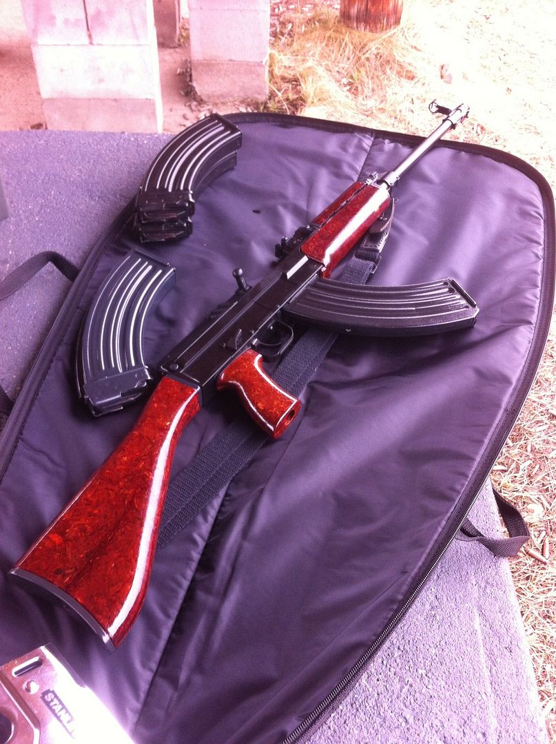

CSA VZ58 back from Warranty after failing to feed.

Update - had mine out yesterday. Ran flawlessly for around 80 rounds. Looks like whatever they did fixed the feeding issue. Thsnks, NS!
North Sylva was actually quick and polite... but we'll see if the problem is actually resolved. And yes, mine is a 7.5" gun... the feed ramp definitely looks different than the one on my 11.5" CSA. I still think the problem was the feed ramp, but who knows, maybe it'll work now. I'll know this weekend...
Glad to hear, Did they clean your rails up like they did on mine? Mine were completely polished off, Finnish removed and the bolt moves much better over them.
They never mentioned this to me when I called but the VZ is my baby and daily shooter so I noticed right away.
