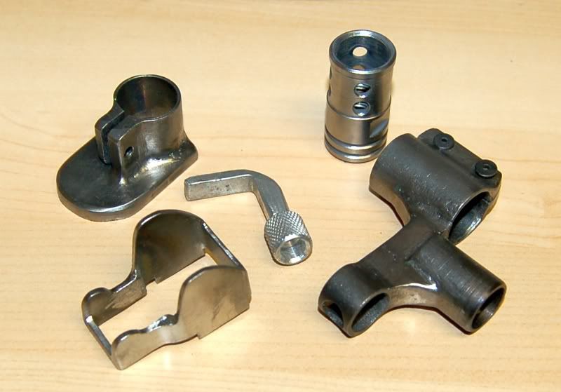

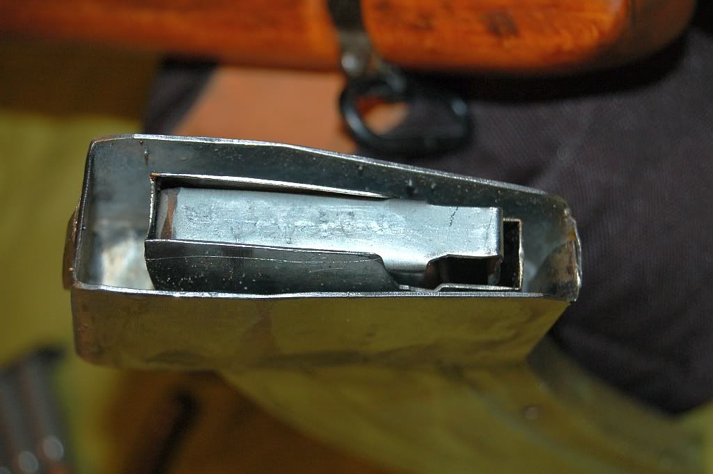

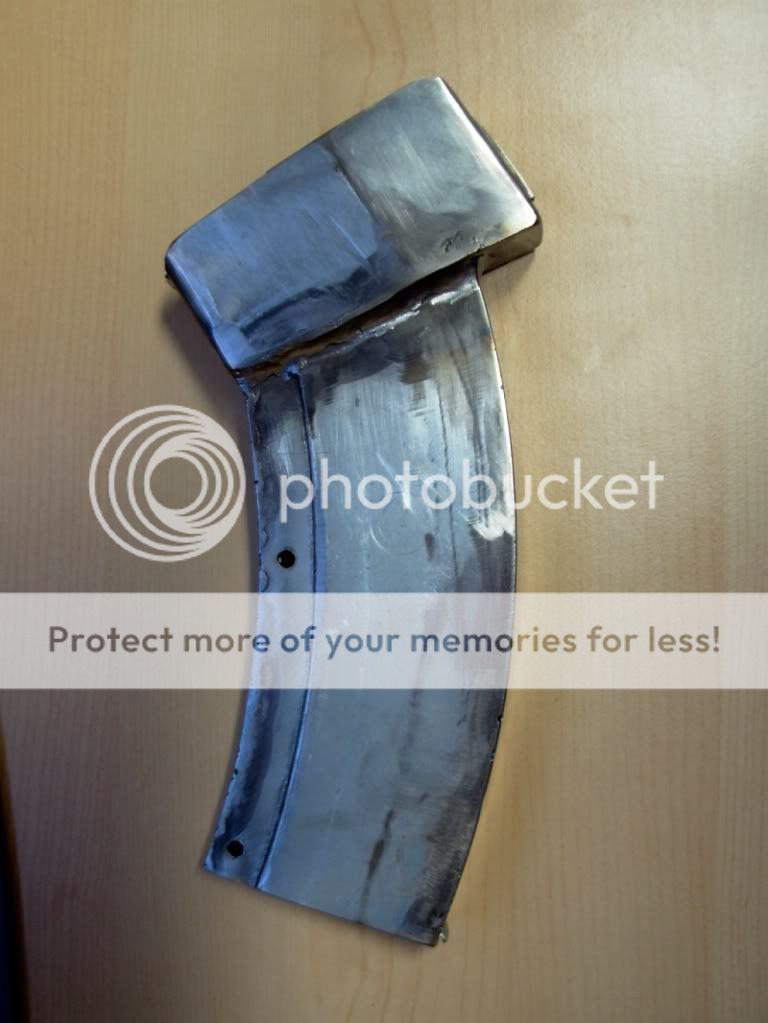

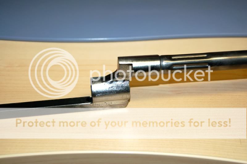

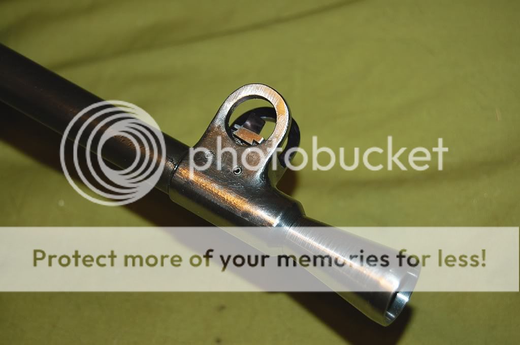

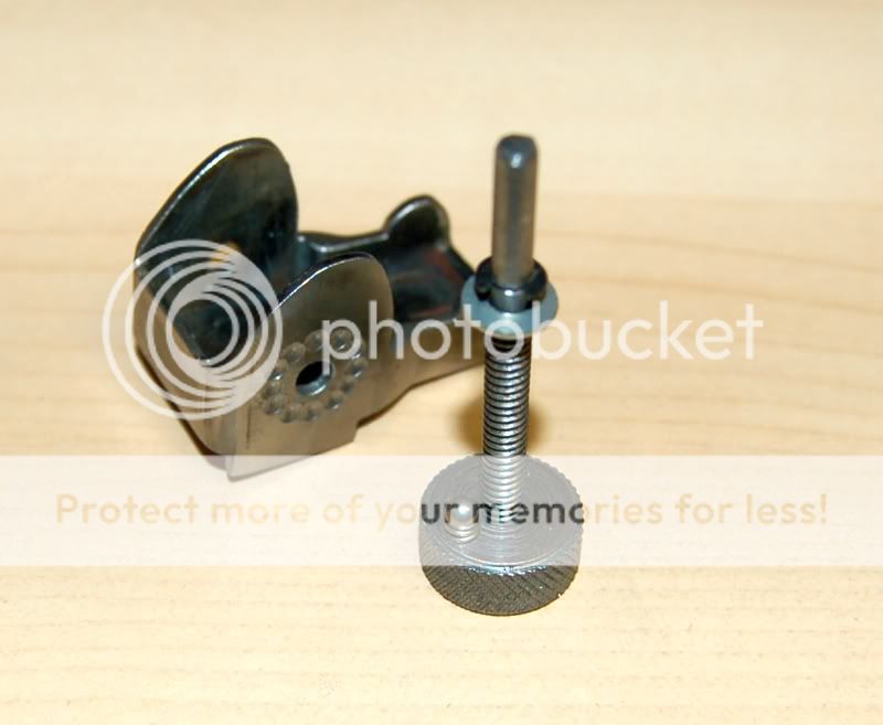

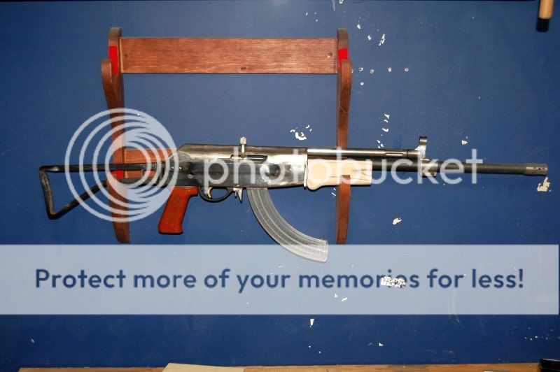

Some simple fabricated parts (mostly mild steel) made with a MIG welder and grinders/hand tools:
I shudder to think what this sort of stuff would have cost to have made, but my time is virtually free to me and material costs are nil as most of it is scrap metal offcuts.
Good luck!

BTW, I like the work that you've done... did you build that CZ from scratch, or is that an actual working firearm that you've modified?

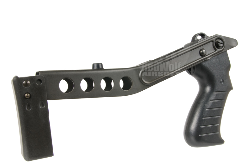

What you should do is get one of these from here:
http://www.redwolfairsoft.com/redwolf/airsoft/Accessories_Grips_and_Stocks_Shotgun_Sniper_Rifle_KTW_SPAS_Custom_Metal_Stock_Set.htm
If I ever get an Airsoft gun, I'll consider it. Till then... I'll stick with one that won't fall apart under the recoil of a 12 gauge.
Ah, now that makes more sense... that actually is pretty close to the design I want, with a couple differences: I want the long part of the stock to be upside down compared with the SPAS, so that when it's extended, it'll be a |_| shape, with the cross-members at the bottom instead of the top. That way, when I fold it up, the two sides of the stock will end up next to the reciever, and the cross-members will end up against the top of it. I'll probably do a slightly different shape and design of the sides as well.
I do like the "buffer" he talks about in the video though... I wonder if I could work something like that in.
