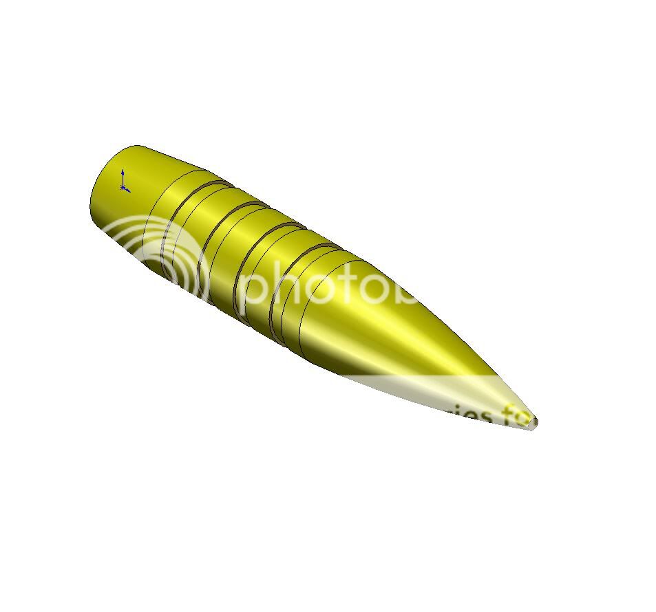

A screenshot of the solid model:
Length is 1.700" (same as the 300gr. SMK), weight as shown is 227gr. The relief bands are a WAG at 0.050" wide and 0.010" deep.
Mark
