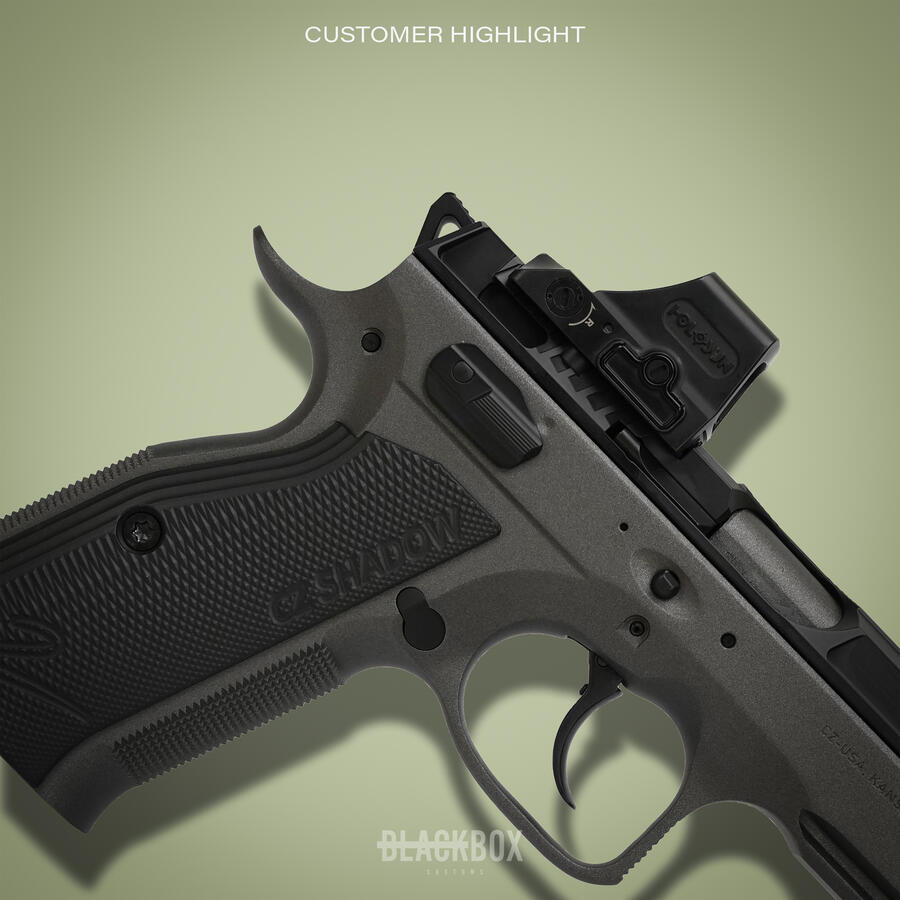

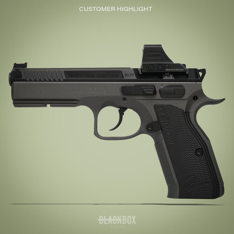

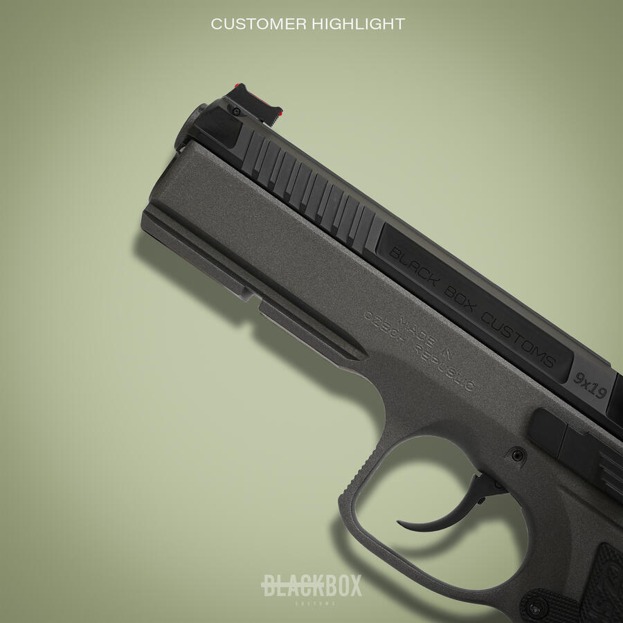

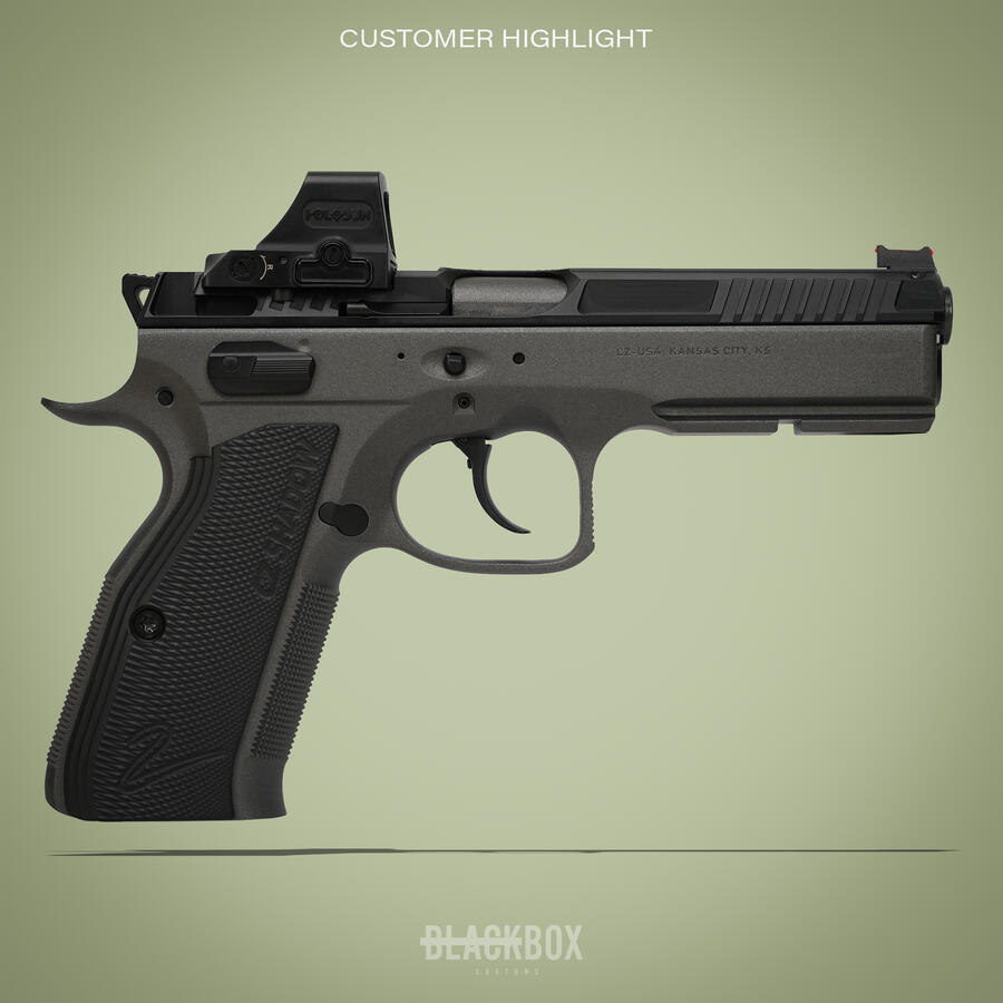

This CZ Shadow 2 was one of the first pistols to receive our RMR/Holosun Press-Fit Post optic cuts. The horizontal plain on the Shadow 2 slide is very narrow and slopes off quickly; As a result the mounting screw holes on the RMR footprint make it too wide for the flat portion of the slide which exposes the threads of the screws underneath the optic. Our shop remedied the issue with a purpose built and fitted mounting post extensions to give the necessary surface area and thread engagement needed for the optic screws. This build is rounded out with our Shadow 2 Carry Optics milling package and two-tone Cerakote in Graphite Black (H-146) and Sniper Grey (H-234). Get your CZ Shadow 2 optics ready at our shop today!
