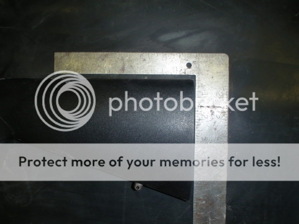

Measure and mark the LOP that you want. Here I'm cutting only a 1/2 inch.
Cut the stock square and clean. If you do it by hand you'll more than likely need to sand it flat and clean up the edges.
Check the depth of the screw holes and re-drill if necessary.
The picture shows a Mossberg 590 stock. The Remington stock, if its factory should have a spacer plate and the recoil pad should have a inner profile that fits inside the stock. I cut this down or get a different pad. A belt sander can acheive any profile issues with the pad so everything is tight and square. Hand tools just takes a little longer but some times gives better results.
