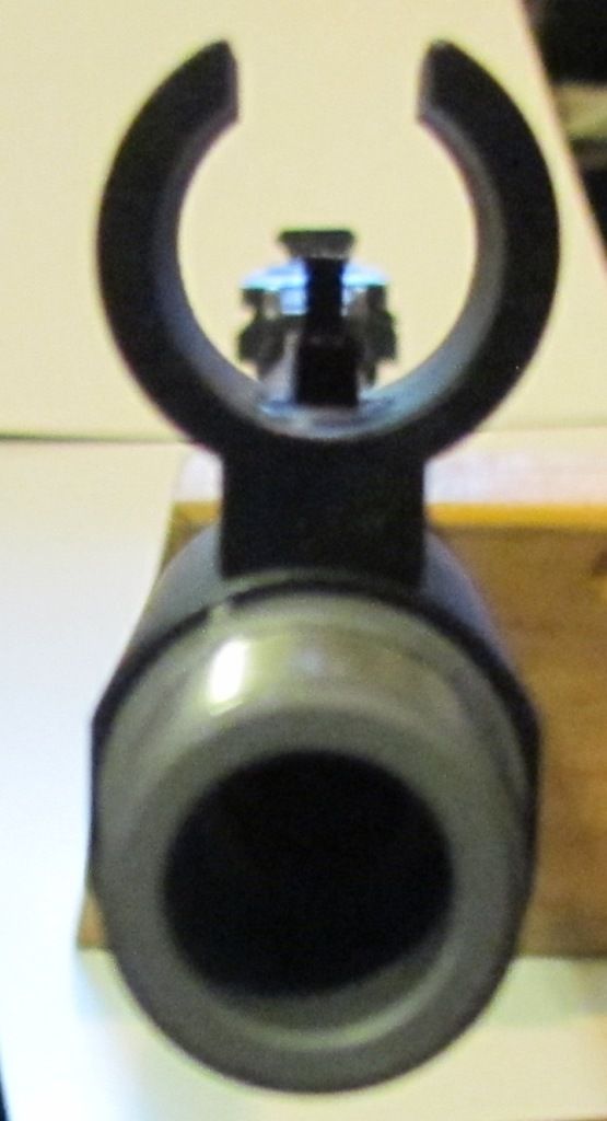

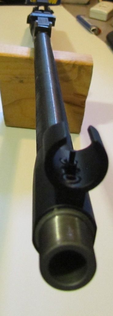

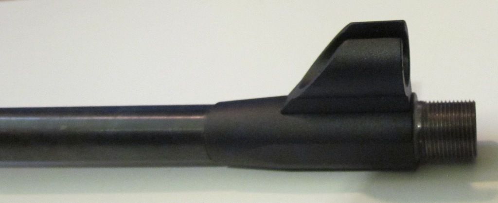

Option I used other then gunsmith was to bore out a No4 front sight base ( No4 bayonet lugs are fatter then the barrel I was using, No1 wont work .550 ID) To the Dia I needed, I need .652 I had a friend bore it out to .650 and fine tuned from there ( emery cloth the barrel ) then drilled an tapped for a sew screw ( used this option being that I felt drilling a slot for the cross pin would be too deep into the barrel ) 40rds and hasn't shifted. Now If you wanted to, you could install the front sight guard, haven't notched out that yet ( almost like the fin mosins )
Wish I used the FSB that uses the screw to clamp the blade in. I found this was the cheapest and cleanest option. Mind you you need to play with the front sight height. Im sitting at 500M sights to hit 1" above at 50.
