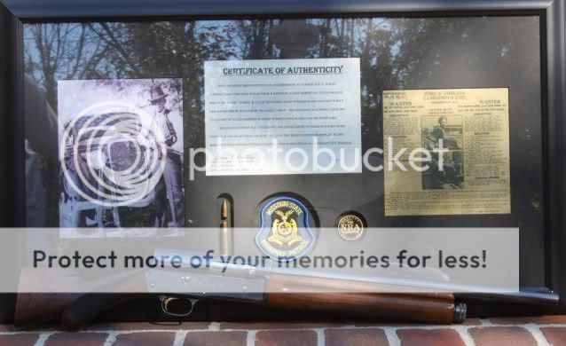

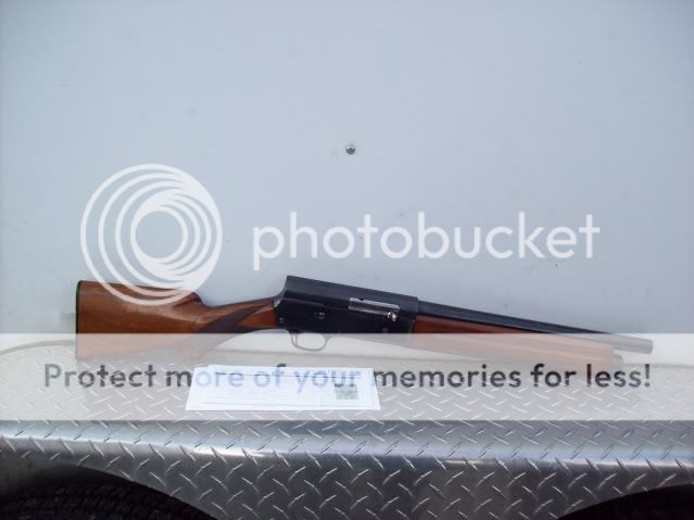

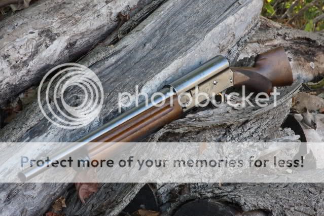

What I need is technical information on how to make it happen.
I though rem 1100 was the same concept as the Auto A5. Did I buy the wrong gun? Did Clyde widen the ports on this Auto 5?
Which gunsmith in Canada can do it for me if I out sourced it. I am pretty handy, so If I new what I had to do, I could do it.
The Browning is recoil operated. The Remington 1100 is gas operated. Apples and oranges. When you shorten the barrel, you change the balance of the gas system, which could result in malfunctions.
