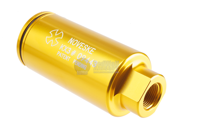

Can you go the other way around ? Cut 1/2x28 threads into existing 14mm CCW thread ? Essentially making an Airsoft "mock" flash hider fit an AR...
Doesn't everybody need a gold anodized KX3 flaming pig ??? :p
An adapter isn't possible. The valleys of the external 14x1.0 metric thread would be down below the crests of the internal 1/2-28 threads. The resulting "adapter" would look like a disfunctional slinky in short bits.
Boomer, there no meet for this to work. The 1/2-28 tap would just scratch the internal peaks of the 14mm threads. The part you have is what it is. It won't fit onto anything other than the 14mm threading without some major machining to it. Machining that would certainly cost more than the part.

On a serious note though, does someone make that stepped adapter BlastAttack ???

I have no interest in having a gold flash hider on my AR15. It was a joke... I saw it while searching Google for the real deal.
I was only asking if the picture you (BlastAttack) posted was an actual product being sold, for the purpose described initially...
