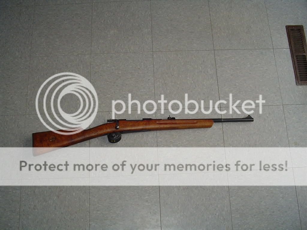

cut to 18.25 inches, ATV/camp gun. I will do a crono test sometime reasonably soon and post the results. With the open sights it will shoot an honest 2.5 moa @ 100m.
Now that is what I want, a small little rifle with more power than a 30-30, I'll probably put true-glow sights on mine I will never shoot over a 100yds any way... was it expenive to put the open sigths on? I really like the look of that rifle the only reason i bought this 96 was to try and sell it on CGN, but now that i have seen that pic I think I'll keep it. I would really like to know the fps with that short barrel
