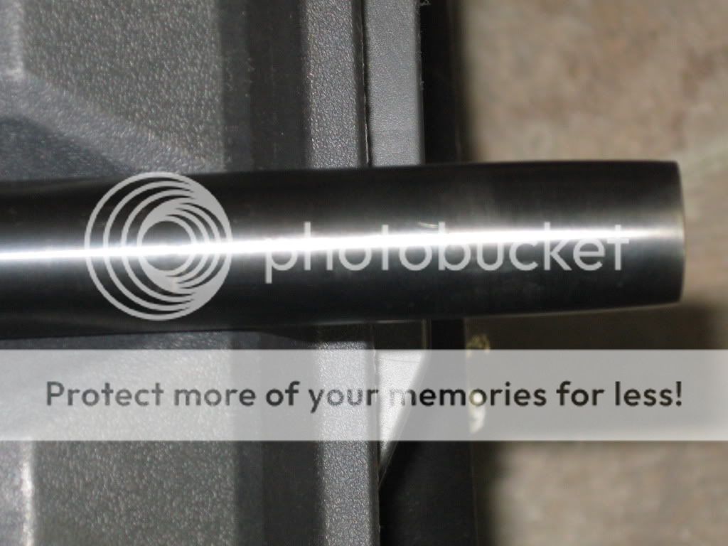

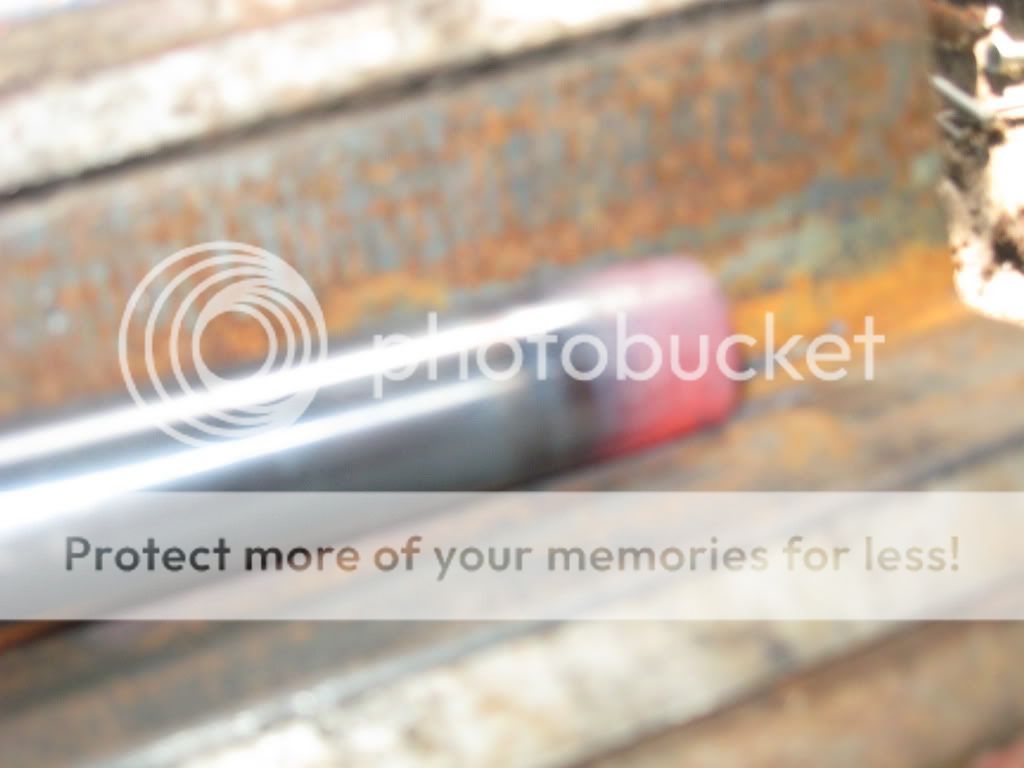

Okay - I started at exactly 2 Pm with no preparations and put the final touch-up blue on at 3:01.
I did it exactly as described - except I did not bother with a heat sink - and the final choke is slightly tighter than full. I will likely widen that just a smidgen when I get home.
During that time I had three long phone calls - one which calls me out of province.
I am on dial-up, so pics take too long - I will try to get first and last.
Admittedly, it needs a little more blue - which seems to colour better if left overnight.
