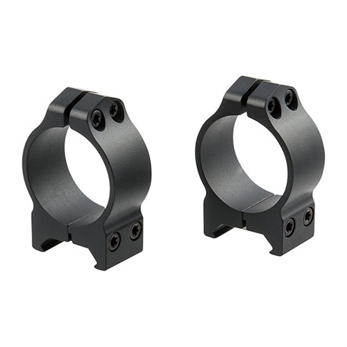

Depending on the magnification ring size, you could probably use low 30mm rings...
Warne MFG makes a really nice low set of 30mm rings
