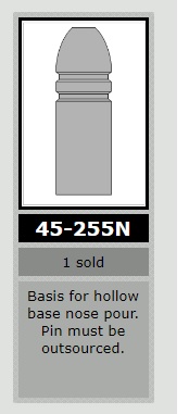

As to the mould, where there is a will, there's a way. Accurate moulds will cut custom designs, and he has a big catalogue of the crazy things he has done for people. He won't do hollow base moulds, but he will cut the mould and leave enough block there for another shop to incorporate hollow pointing pins.
A quick glance suggests Tom has indeed done this for something like a Webley. I see 3 designs that might be in your range.
