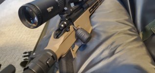

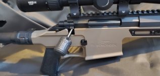

I picked up an MDT clamp on unit for my BCL Bison. It didn't have the threaded knob so didn't have too many options. I grabbed the one that looked the closest to the shape of mine, heated up the knob a bit and press fit the MDT onto it. Works perfect for me.
