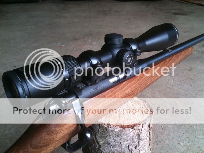

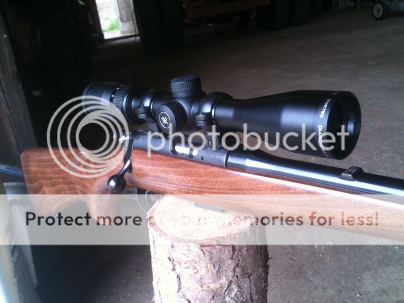

I've been staring at my Scout for over a month waiting for the new vortex crossfire II's to come in, and I got tired of waiting! I switched my order to the first scope I looked at because it was in stock and I realized it was probably a more suitable fit for this gun anyway. In the meantime I experimented with some bedding using leather that didn't work for me, I ended up just doing a traditional epoxy bedding in the front and rear action voids, but left the sides and center wood as is.
I was going to put a crossfire II 6-18x44ao on it, but I opted for a vortex diamondback 2-7x35 rimfire with 50yard parallax, I'm very happy with the decision! This diamondback scope is unbelievably clear and has a decent .3 moa v-plex reticle. Given the size of this scope, I can't fathom how big the 6-18x44 must be. I mounted it with Burris signature ZEE medium rings and J&P 11mm adapters I picked up from Looky.
So today I'll see what this rig will do at 50m... I have some CCi standard velocity and SK standard plus to run through the paces. It has been shooting about 3/4" groups with the CCI up until now with a really old bushnell 4x that has a thick post and crosswire reticle. I'm hoping the better glass and sk standard plus will outshine my previous efforts.
I think now that I'm using a scope with smaller objective, I can replace my homemade sight blank with the original rear sight. Shame, I put quite a bit of work into that... Slow rust blued and everything.

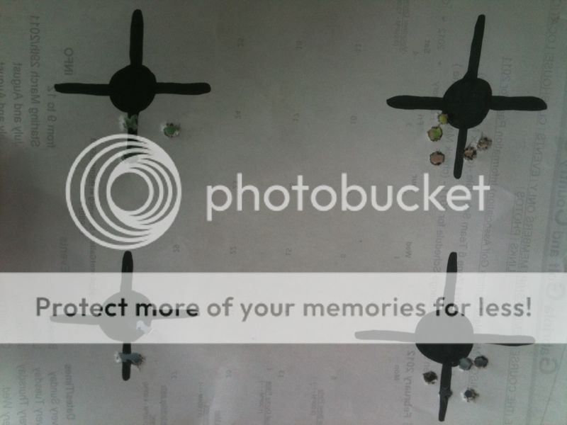

Glass is very nice! Super happy with the whole setup. Here are all the groups I had time to shoot today. All are 5 rounds at 50m with a front rest only, unsupported rear.
Best groups were my last two.
That scope looks big enough on that rifle. A larger scope would dwarf it.

That rifle and scope look real good together. Looks like it's gonna shoot just fine too. Nice! :cheers:
Thanks... I'm staring at it quite a bit!

Here is 10 rounds of SK standard plus. you can see the effect of the strong left to right wind. I called the flyer... i flinched.
10 rounds of CCI standard velocity. This lot of ammo has been notorious for over charged rounds sending a high flyer.

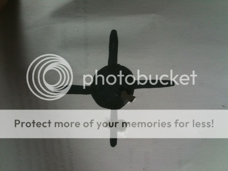

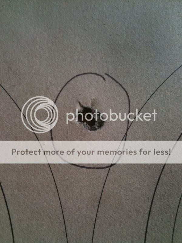

Best group of the day was shot by the SK, and i was shooting at a .303 british bullet hole in the paper after i had zeroed the POA to the POI. I put my last 3 rounds of SK into the hole. I know, it's only 3 rounds and hardly qualifies as a group, but i was pretty impressed none the less.
My last 10 rounds of CCI standard was sent down to the 100m mark. This really surprised me. I was careful to only shoot between gusts of wind... and it paid off. The group was about 1.5". Again not my best shooting, but pretty good for the ammo, and a scope with 7x magnification and fixed 50m parallax. as far as i could tell by checking the back of the target, 4 bullets went through the same hole at the top of the group :eek:
