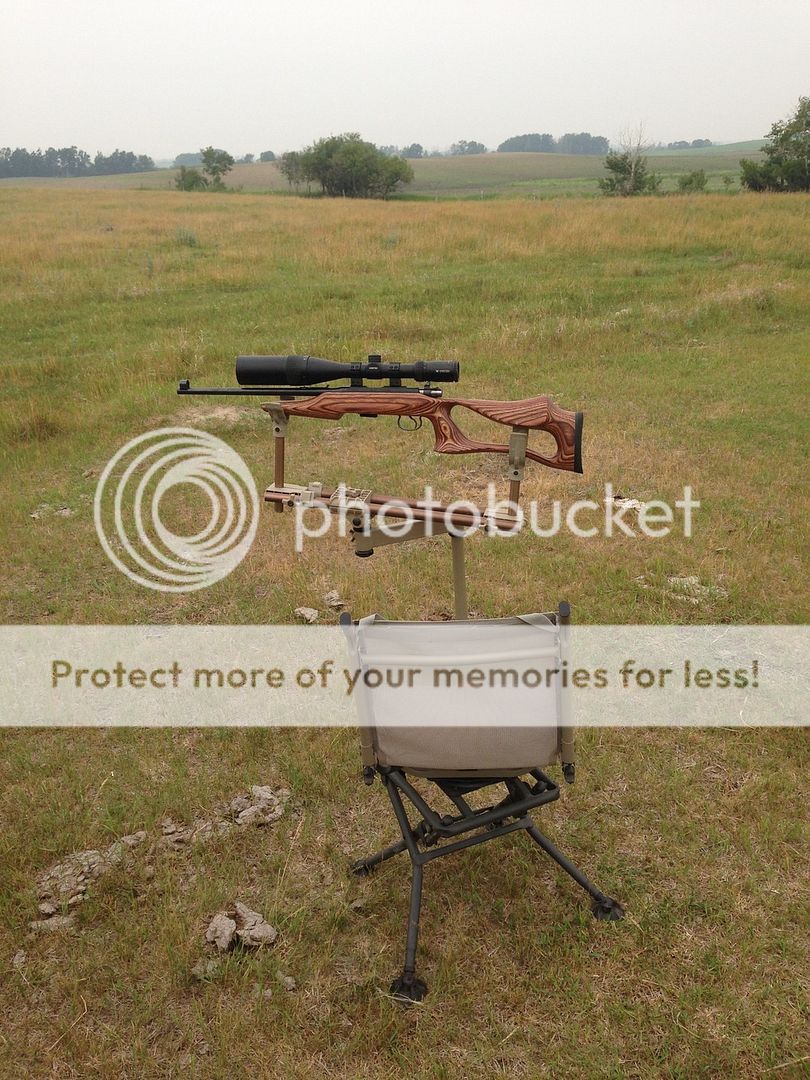

My Scout is a little overboard. Gopher getter in the pasture. 452 stocks fit. Some sweethearts don't need lipstick, fancy bottom metal wouldn't make it shoot any better.

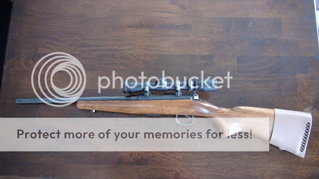

- If you are using a Leupold FX-1 Rimfire, you have the option to mount your scope low as the smaller ocular diameter that comes with that scope won't interfere with the CZ bolt. I use Burris Rimfire/Airgun rings in Medium (420069) with a Leupold 2-7 Rimfire. The scope fits nicely behind the rear sight. It is possible that you will faintly see the image of the front hood at 4x. Another good option for mounting your scope low is Talley CZ Rimfire Rings Low (22CZRL). These rings are slightly higher than the first option and they are also negligible lighter. Here is a spread sheet with some other CZ scope/rings options that have worked for me in the past:
- I have used my Scout with a CZ Silhouette stock in the past. It was a very light set up but I didn't like how the rifle balanced so I am back to using the original stock with a Pachmayr slip on pad that gives me an extra in of pull.
