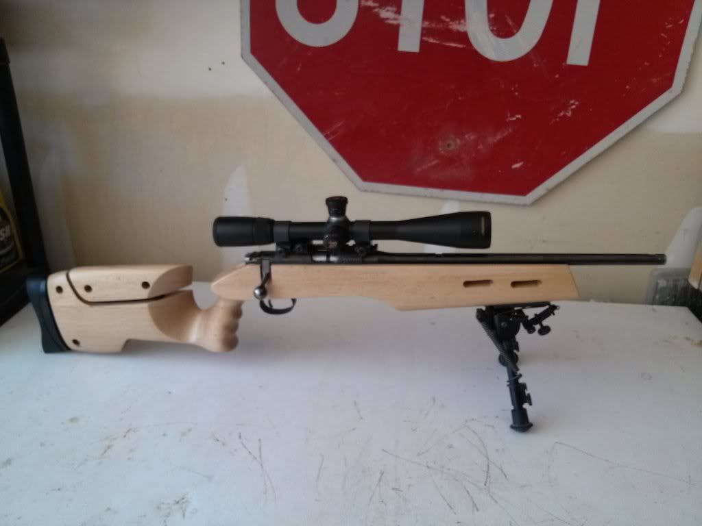

Just thought i would share this with you guys that have cz rifles. I installed my Yo Dave Trigger kit in my gun, and got it down to 5 oz safely. and there are other springs included with the kit if you want a heavier trigger pull. Also comes with pin shims for sear engagement. Well worth the money and super easy to do!

That's a beautiful stock on your rifle. Do you mind if I ask where you got it and what it cost?
