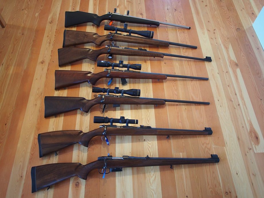

BeanKozi- Thank you for the input and very nice lineup you have! Your FS looks great.
