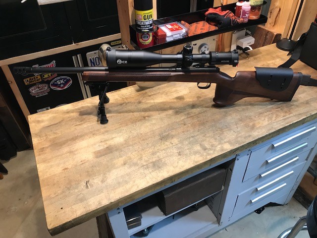

Ribs, You're right about the height of the scope. I have adjustable parallax and if it's adjusted correctly the cheek weld isn't critical. I could put a riser on if I wanted but I like the look of the wood. I saw some thread where the owner drilled and put a kydex riser on. I'm not that guy, but I do have one on my B22 FV.
