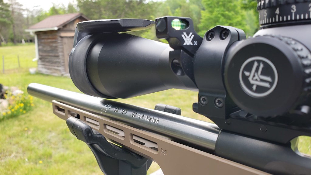

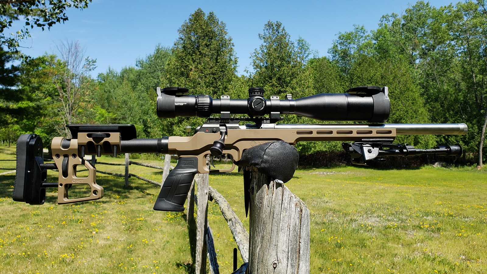

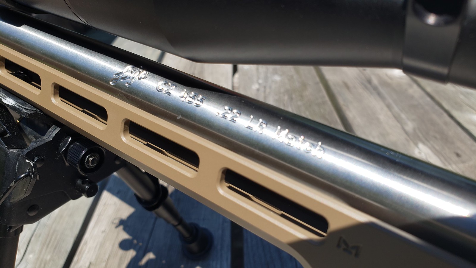

I received and installed my 16.5" Lilja barrel from Go Big Tactical last week.
The factory barrel headspace was 0.045". I shimmed the Lilja barrel for a headspace of 0.042". Unfortunately I left the shim kit at home so I'm unable to test for headspace. CCI SV and SK ammo have a rim thickness of 0.041".

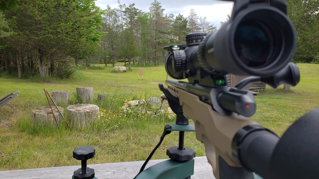

Winds wouldn't calm down and got impatient so did the 50 yards and waited for any windows of opportunity to shoot my groups an now the thunderstorm just rolled in.
Still going to test for groups in the future with headspace. No regrets with this barrel purchase.
