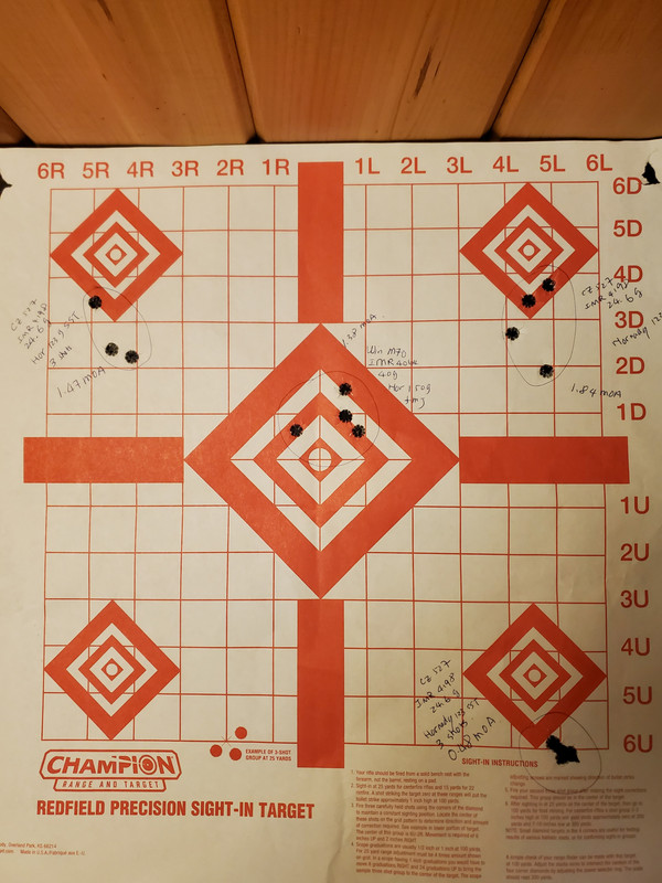

Made a trip to the range today, to try again a load that the CZ 527 seemed to like - IMR 4198 24.6g and Hornady 123g SST. For reference, I shot my Win Model 70 featherweight compact in 308, which usually shot one moa or less.
My model 70 shot 1.38moa. Its windy at the range today.
I shot 3 groups with the CZ 527. The first group was 1.47moa, second was 1.84, and the third was 0.48.
I believe that on a good day, the CZ 527 is a moa gun. I have decided the CZ 527 in 7.62x39 is an accurate rifle. It can not and should not be expected to shoot like a target rifle with heavy barrels.
I tried the set trigger. It was so light that a touch on the trigger, the gun would shoot off. I didn't find using the set trigger yielded better accuracy. I find that the regular trigger is nice enough.
