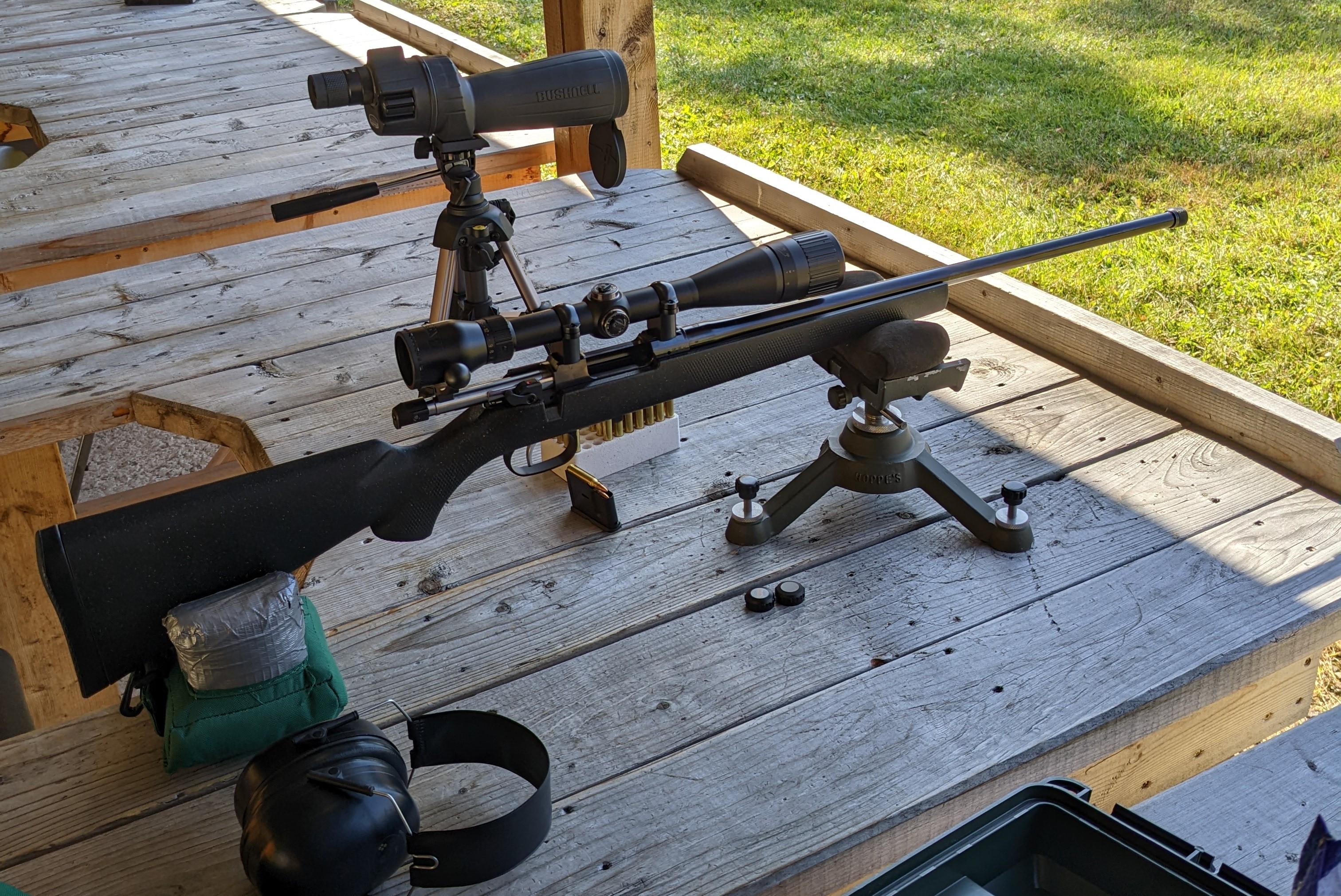

Warne medium fixed rings with a leupold 2-7x... I just couldn't find the QD rings at the time.
