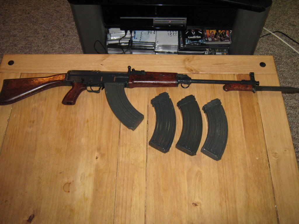

Cz: 858 2
now my friend all you need is this:
1. Windex with amonia
2. wd40
3. 7.62 metal brush or .30
4. cleaning patches over and over untill they come out clean use wd40 as need to mosten up the barrel and the debree
5. copper remover " hopes " OVERNIGHT!
do step 5 overnight but only after steps 1, 2, 3, 4 have been done.
6. brush down again after waiting the night. uses patches till it comes out clean.
keep repeating the step 6 untill patch come out clean.
people can ##### all they want about step 5 and 6 but its true and i bet half the cz 858 guys have never done this. try it you will be amazed what comes out! if you have copper down the barrel the patches will come out blue.
then coat the barrel with some wd 40 and your good to go!
