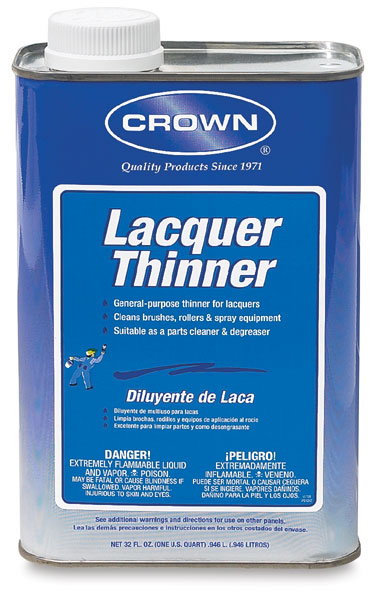

Other guys reading this - any solvents work particularly well on the lacquer crap? I use wipe-out to clean most barrels, and I don't think it is effective against this problem.
Try and find a M14 brass chamber brush and go to the paint store and buy some lacquer thinner. Scrub clean the chamber & then clean the rest of the rifle like normal.
Once this is done try some JB bore cleaner & bright to help this from happening less frequently. Also time from time ensure that your spring on the extractor has not been broken.
