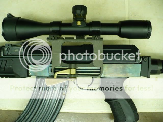

i bought a NEA cantilever mount from shooting edge... its awesome if you have the after market stock piece! easy to use always holds zero and it comes off fast to for cleaning!
This is the way i'm now running my CZ, after 2 years with a side mount (drilled and tapped into the gun) i decided that i wanted someone different and i went with the cantilever mount from NEA, really high quality product!

I also purchased one of the NEA cantilever mounts, which is going on one of my 858's. The reason I'm interested in a side rail is that I have another one I'd like to keep looking more "original", and an east-bloc side-mount scope would fit in well with that.
I still have my side mount (can't really remove it without seeing nasty taped holes) so the no gunsmith mount would be great, but for ease of use the cantilever mount is the way to go.
The look is great i have to agree, but the sight in is so painful it almost hurts when u do it the first time.
