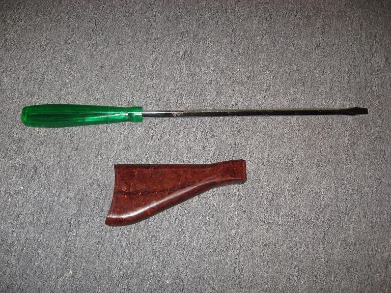

Thanks for the suggestions guys. I thought for sure I would need a jackhammer and a flame thrower. But in the end all I needed was a bench vice, my newly acquired 27 inch screwdriver and a favour from a machinist buddy. Took him two minutes to diagnose and solve a problem that I was baffled on for 4 hours. His professional opinion was to use heat as a last resort and even said that a propane torch may not have been hot enough. Anyway she off and the new one will be on shortly. I will post pics when she is done and of the ridiculous screwdriver I needed.
Here she is. Works perfectly on the stock bolt, no so perfectly on the folding stock bolt or eyeglasses.
