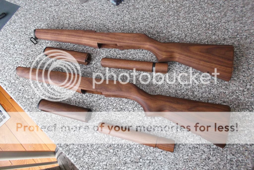

So I had a CZ 858 with a wood stock that was beach blonde in colour. I have now changed it to something a bit more appeasing to the eye.
I usually stain, then polyurethane my stocks, because I enjoy the shine it gives. On the cz858, I had the poly coming off from the heat on the hand guard and the gas cover.
So I went a new route and have started using Tung Oil for the first time. I am only my 4th or 5th application now. But each morning before I add on the next application, the wood is really dulled. Will Tung oil ever keep the stock vibrant bright colour and shiny?
These pics are what it looks like immediately after the application of tung oil. I like it. I wish it would stay that way.
Will tung oil after more applications start to look better and better? Or is there some sort of ploy/shellac/varnish/clear coat i can use on top of the tung to give it a lasting shine?? But i guess that would have defeated the whole pitn of using tung oil in the first place then. haha. well I live and learn i guess ;)
for tung oil that's a real nice shine. is it pure tung oil, or a hybrid? your wood is now weatherproofed, touch ups are a wipe of oil a month. the grain will get richer with time. looks like beech to me, walnut comes up real nice.

Ya it looks nice in the pics, but thats because i just added the oil a few minutes prior. But the next day, it will have lost all of that deep rich colour and the shine. I was wondering if after the 20th, application, it might start to keep its colour and shine??

The top stock was done with tung oil, the bottom was done with boiled linseed oil. I prefer the tung oil myself.
