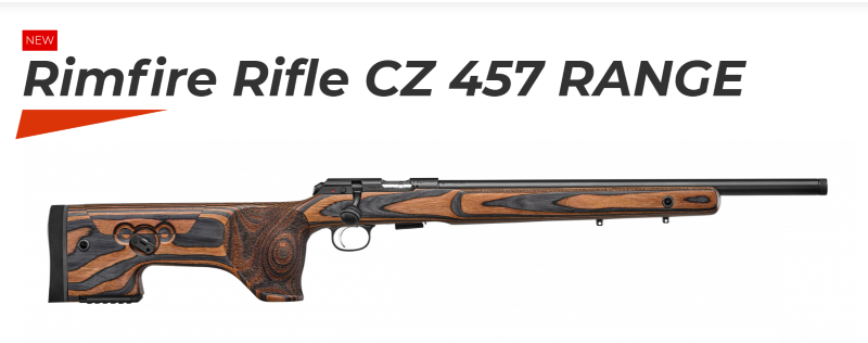

Alternatively, forgo the American and get the new CZ 457 Range, also available with 20 and 24 inch barrels. This model has the CZ match chamber.
