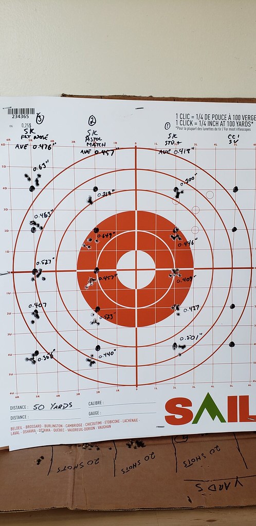

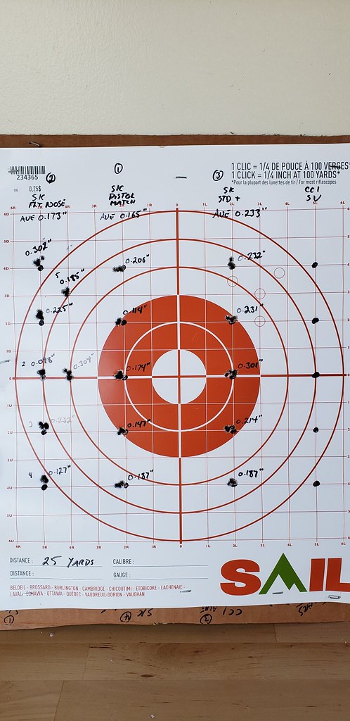

Here's a target sample of my first set of testing from my CZ 457 MTR with the factory 16" barrel before I bought a 16" Lilja barrel.
I'm tempted to pick up a longer 20+ inch barrel from IBI but at this time my 22lr hype is calming and getting back into CF with my Tikka CTR 223.
