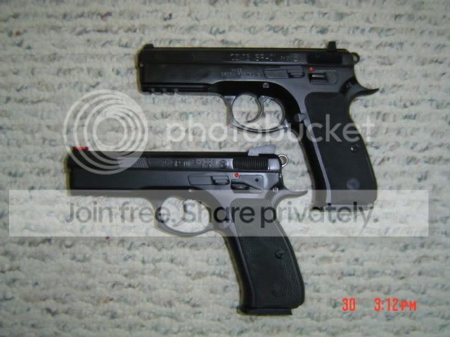

I now have both the SP-01 and the SP-01 Shadow. Both at the present time are bone stock. They both are the three slot versions. I want at least one gun for SSP IDPA , preferably both. If I can't get the weight down to 39oz for the Shadow it will be my IPSC Production gun.
Both guns have identical frames and are listed on the CZUB web site as weighing 1180 grams. My scale shows the SP-01 to weigh 40.5 oz while the Shadow weighs 41.2 oz.
The Shadow has fixed compettion sights while the SP-01 has fixed night sights. The Shadow has the CZ85 trigger which is chromed while the SP-01 has a blued trigger. Take up in DA is a tad shorter with the Shadow over the SP-01. Triggers on both guns are very smooth and light.

By my calculations the SP-01 will be legal just by changing the grips.
The Shadow with all the above changes will weigh in at 38.9 oz. Life is good and the universe is in balance.
