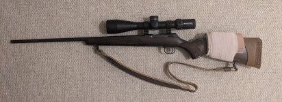

I just wanted to report back on the SportsMach ATP34 rings incase anyone else considers a similar setup in future. In short, they are a solid alternative to using a picatinny rail adaptor & more common rings.
They have both elevation and angle adjustment in the base meaning they can safely apply variable cant to the scope. I have set them up at the same height for now and can raise the rear if I feel the need to in future. This would be done by first loosening the angle adjustment on both rings and then raising the height of the rear ring only with a screw.
They are very well made and totally solid when locked down. They come with a recoil pin and are centerfire rated so I have no concerns with mounting a big 5-30x56mm, 34mm tube, scope directly on an 11mm dovetail.
This approach is also cheaper as I only bought rings for approx. $120, not rings and adaptor.
The only negative might be that they are high, even in their lowest setting. I guess the total height is comparable to low rings sat on a picatinny rail adaptor. You will have to excuse my temporary cheek rest in the picture, now things are mounted I am working on fit.
