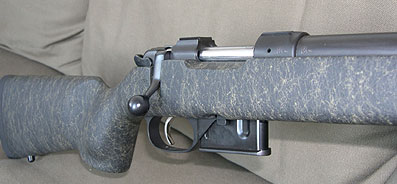

Right now I have a cz550 in 22-250. And I think its an awesome gun, and I love the trigger. I just dont like how the round is so hot.
I was thinking the .308 might be make a good tack driver. But it doesnt seem to be mentioned much. most people about about the rem vs the savage.
So I assume i can expect great finish and one of the best triggers I have ever shot with. But is the gun going to be accurate enough to be say competition worthy in the 500 meter range?
This should work CZ 550, in .308 , 1-12 Twist , Varmint Kevlar
The 527 Varmint Kevlar in .223 , 1-9 Twist
This is the stock I have on my 22-250, and I really like it, just feels "right". the 308 (and .223) are available in it.
But is the kevlar one better? I havent had a chance to hold a kevlar one yet.
Would the .223 be a better round?
I hate to say it but the reason I went with the 22-250 over the .223 the first time around was the bigger bang, the .223 just seems too much like a .22, and a .22 just seems like a pelet gun to me now.
I would probably just stick more with my 22-250, but I can only get off like 8-10 rounds then i have to let it cool for like 20 minutes.
