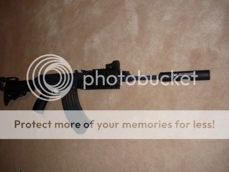

After finally getting the front sight off (they really build up the coating of paint!) the latest incarnation is almost finished - I still need a few other pieces,CTR rear stock, maybe an AVG and the yet to be released NEA gas-block/front sight combo. I'm also contemplating shortening up a couple of the neutered mags for a more compact feel. More non-restricted goodness.
