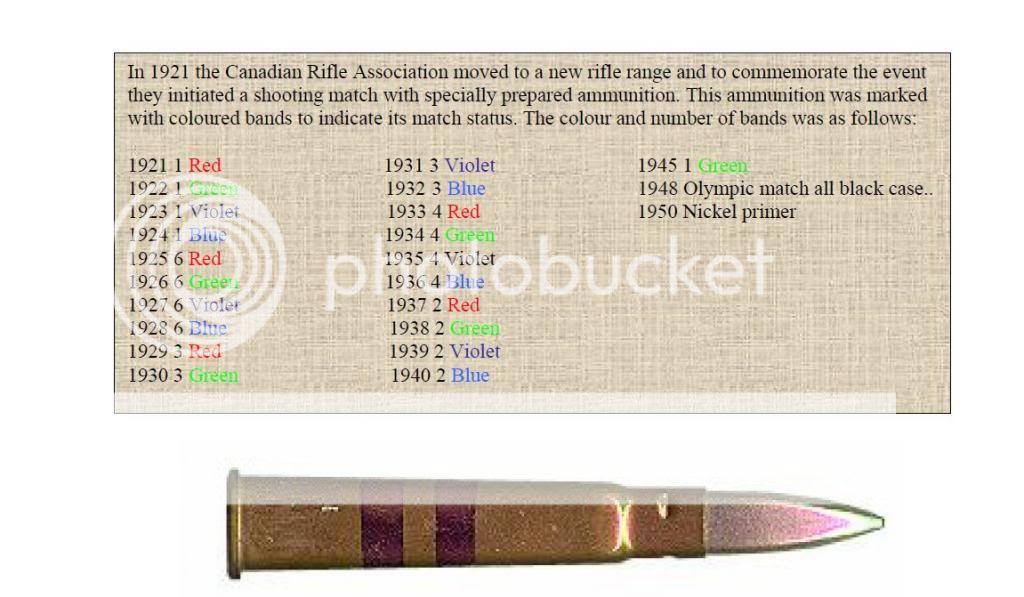

According to MacDonalds book on the Canadian 303 they are for the 40 match, with 'Gentian Violet' bands, a colour used every four years. No further details.
I have a number of these rounds from different years in my collection, and somewhere I have a list of the colours by year. I will try to find it.
The practice continued for a few years at least after the change to 7.62mm NATO.

That's confirm what I have found, thanks

You see it from time to time, its not common, but at the same time no one seems to shoot it, so it just seems to cycle around the gunshow/collectors circuit. Its usually a 3-5$ a round kind of deal, maybe a few bucks more to someone looking to fill a niche in their collection.
Few odd pages from MacDonald, match rounds are in there somewhere.

Many thanks for that, I still cannot find my copy of that list!
