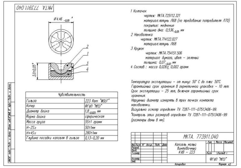

If you could confirm the differences we'd all appreciate it I'm sure! If I recall the primer charge was the same in both the Dominion SPP and SRP, it was just a few thousandths difference in the cup dimensions, my memory isn't all that great though.
SP:
LP:

The point I picked off this drawing that could help the non-nerds:
KVB-9 (pistol) 0.48 mm cup (~19 thou)
Standard North American primers are around 17 I think.
KVB-223 (rifle) 0.536 cup (~21 thou)
Standard primers are around 20 I think. Small rifle magnum more like 25 thou.
This explains a few things about them being slightly harder to seat and set off. I use the rifle primers in some handguns with beefy springs and they work fine. I've used many of the pistol ones in handguns with reduced springs. You just have to seat them well. Using pistol primers in 223 would scare me.
It looks like there might be more compound in the pistol primers (!)
No, I don't read Russian. I just read nerd.
While reloading 223 at pretty much max loads, I've had many primers blanking (piercing) with standard small rifle primers. Magnums fared better from this point of view.
This is why I wouldn't use pistol primers. They're even thinner.
I used SRP in my Shadow with a reduced power hammer spring (13lb)
They worked fine. No misfires.
Looks like you guys are right about thickness. I don't think I would try the SPP in a rifle.
