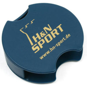

A few things I couldn't live without
- Gehmann pellet box
- Little do-that to keep the pellet tins from spilling...
