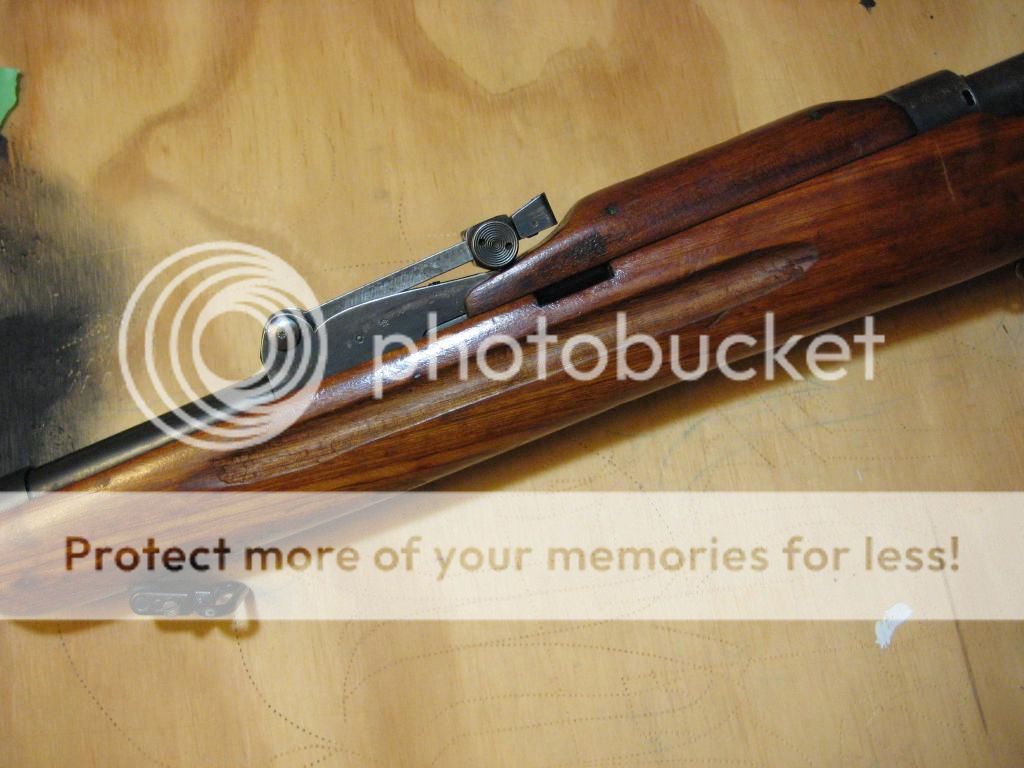

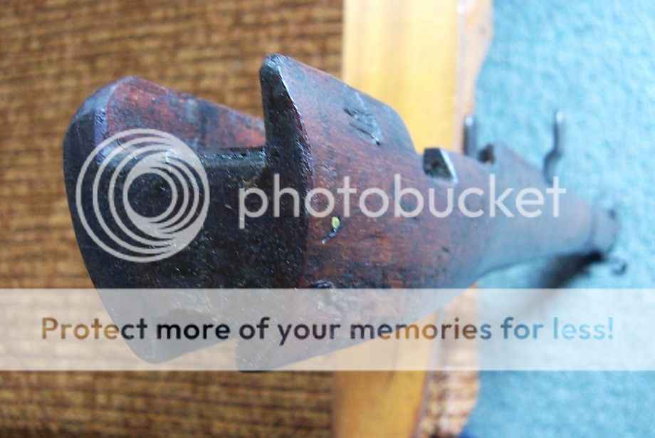

I'll try and describe the rear of the fore stock, I'll have to get some pics of it all when I take it apart when I check the bedding. The sporterized fore stock had the bolt plate installed and the grove in the wood up to the top. When I recieved the new furniture the rear face of the stock didn't have the bolt plate and the grove where the bolt end would sit in the stock was minimal. In order to fit the lower stock I had to carve the groove longer in order for the fore stock to seat around the action, once caved out it all slid home with ease.

If the end of the forend is not relieve for the Stock bolt keeper plate, then it could be a Ishapore forend.
Ishapore.

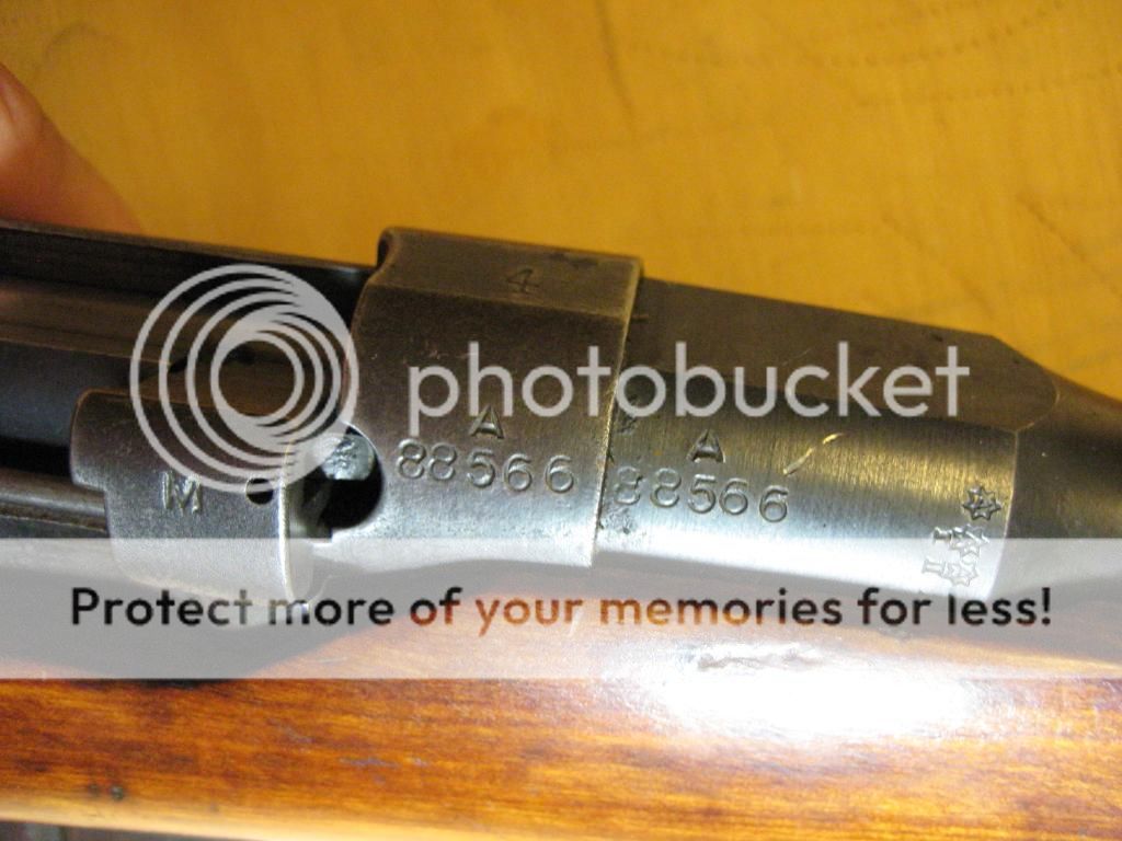

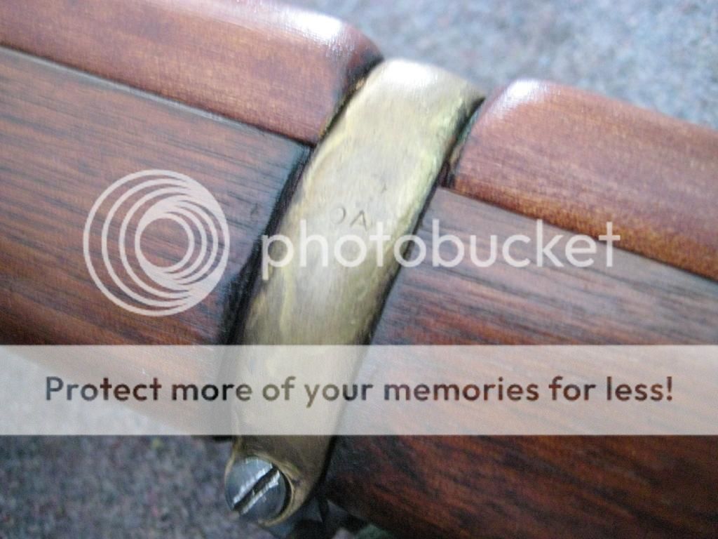

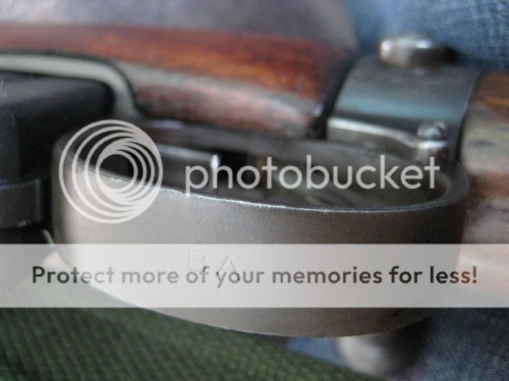

I'll try and get some pics up, it's not dark like an Ishapore or some of the British enfields I've seen. Pretty typical Lithgow looking finish, it has the SLAZ 42 stamp under the brass butt plate. Nose cap is stamped BA, as is the trigger guard that was on it when I took possession of it. Butt plate and front brass band are stamped OA, it has the HV high velocity stamp on the barrel. I tried pretty hard to track down as much Aussie parts as possible, I'm missing a bayonet, sling and an oiler. I picked up an oiler and pull through at a local gun show last weekend but it's British or possibly Canadian iirc.

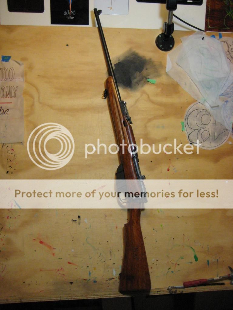

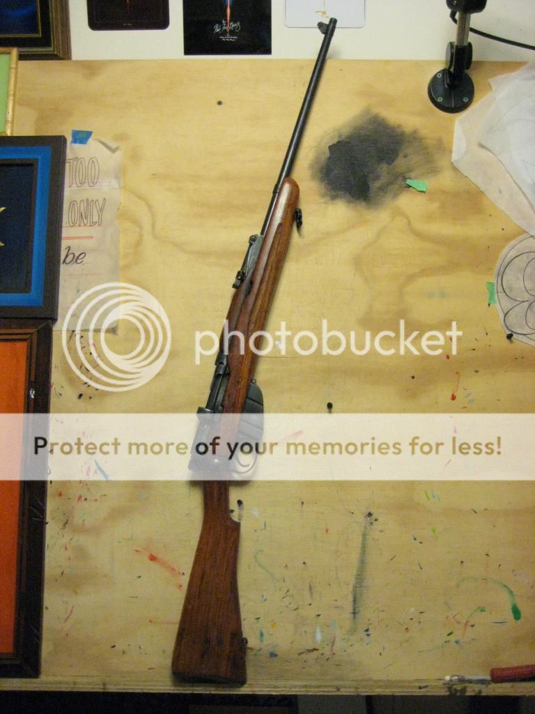

Finally found a bit of time to finish the old gal off, installed the recoil shim plates. There was a bit of fore and aft play in the lower fore stock which is now nice and snug, the lower stock clicks in easily with no play now. Installed the butt screw plate for added measure, carefully marked and chiseled the recess for it and epoxied it in place. I'll be taking it out for its first shooting next week, pretty excited to fire it. I always tried to get my dad to shoot it, it's about time it saw some use. Hope it shoots straight, I'd love to have this Aussie beauty as a reg shooter.

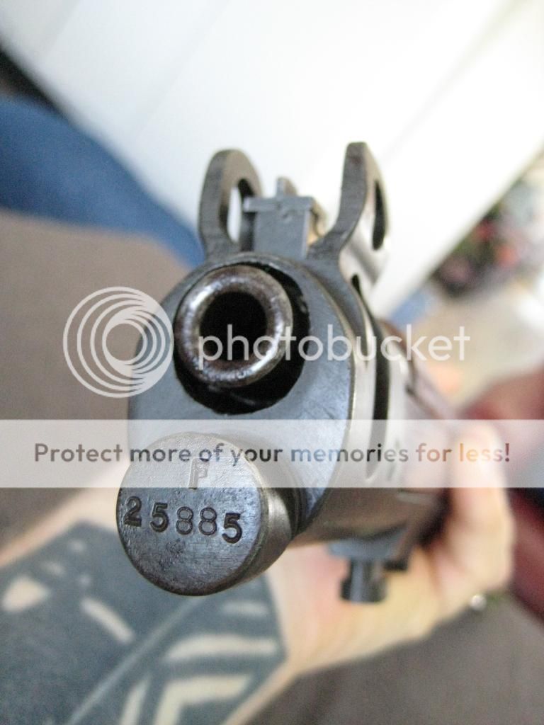

Tracked down an Aussie bandolier and some stripper clips as well as a matching sling, just need to find a period bayonet for a decent price. Does anyone have a lithgow nose cap in the A88566 serial number range they want to trade or sell? I'm matching numbers on the action, barrel, bolt, rear sight but not the nose cap. It's stamped F25885, still has the kahki green paint on the inside face.
I'll try and get before and after pics loaded this weekend, very pleased with the way it looks now.
From what i see & from your comment about it not being relieved for the keeper plate at the rear, your forend is a Ishapore made one & most definitely not Australian.
@5THBATT thanks, that makes more sense on why the butt screw plate was not there. Ah well I can live with it regardless.
@woodchopper thanks for the heads up. I'm not sure why I didn't catch that, I've been looking for one in the right serial number range anyways. It was a freebie from the guy I bought the wood set of off so it didn't cost me anything thankfully.
