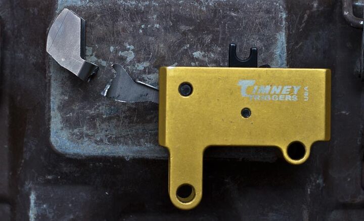

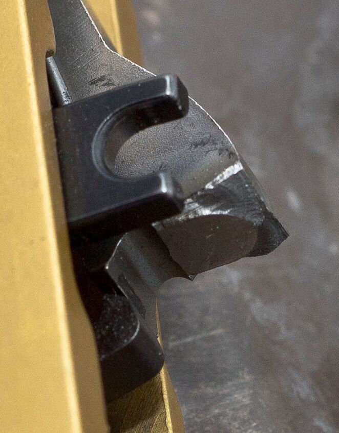

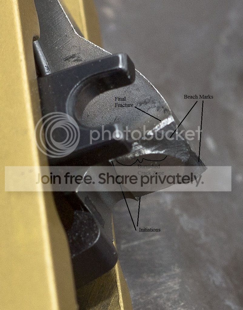

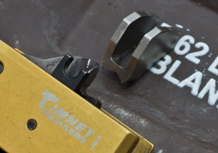

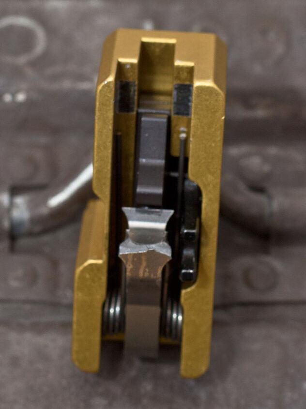

Lol all in all its actually pretty funny. Given the surface is nearly all beach marks it was a long time coming. Surprised it lasted that long.
Steel type wouldn't have changed much if there is inherent stress concentrations. Low cycle fatigue to start with would ruin anything. Otherwise material would have changed it from 2000 to 2500 shots instead. A broken trigger is the result regardless.
I'd just call it poor design.
If you were following the circumstances of the 3 known Geissele packs that failed, they have all been attributed to one bad batch of hammers that slipped through QC. In the US if this happens Geissele overnights you a new one... that a lot more acceptable than what Timney does!
That is what the engineer at work suggested as well. Amazing what the lack of a radius will do to a part.
Same reason all airplanes have radiuses on their windows now.
they had too many corners cut on this set, and now we have the cheapest and weakest hammer exposed right there. I am only surprised that this has not happened more frequently.
